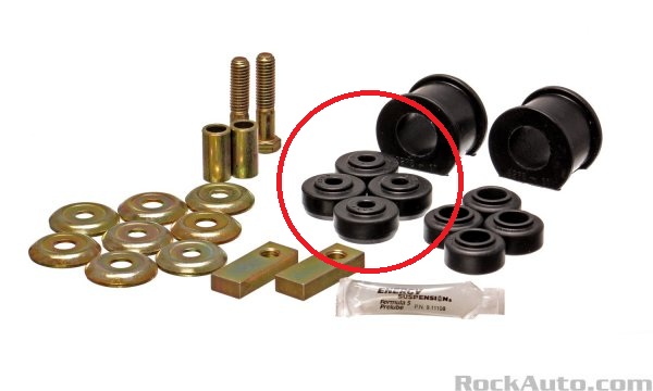

I have not yet disassembled the attachment to the k-frame. But it seems to consist of two bushings per side (according to the ENERGY SUSPENSION kit). Do you know what the dimensions are? In the package were two for the K-frame, but I have this drilled up to make fitting to the control arm. ID was around 1/2 ". Thickness 0.63".

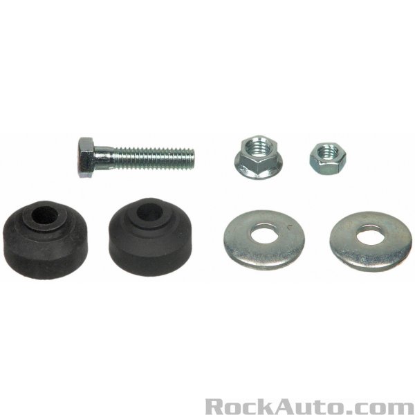

OK, I thought you were talking about the bushings that go on the top of sway bar brackets to the K frame. It appears the kit K7304 above shown has a bolt which is not needed so maybe that is for the end of the sway bar but I don`t think so since the holes look small in the pic? Or maybe it is a universal fit for other models too ? My 77 parts book shows 3879219 for the number for the kit that goes on top of the brackets or links (whatever they are called). The kits I have don`t have a bolt (since the bracket is threaded), there are two bushings, two washers and a nut. I was trying to find out if the 3879212 kits that I have will interchange or not. I don`t have a later year book to look in. The ones I have are like these. NOS MOPAR CUDA CHARGER SWAY BAR HARDWARE ATTACHING KITS 65-74 | eBay
The 3879219 mopar kits aren`t out there from what I see. I`m sure Moog or someone else makes them. The K7304 kit may be what you need but the bolt kinda throws me off. The bolt might be for the bottom end off the bracket where it goes around the sway bar???

Not your fault. It doesn`t take much to confuse me. LOL I think the kits I have will work but you should be able to find them pretty easy. I don`t know how hard it is for you to get stuff for these cars locally to you. Amazon has the Moog K7304 kits for $5.44 each. Does Amazon ship to you???

ordered that Moog part on rockauto. Amazon does ship the parts to holland. But couldn't fill up the shopping cart to get the free shipping ;)

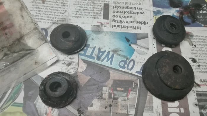

I let know that the Moog set fits great. The original rubbers were due for replacement. And these did indeed consist of two separate components.
However, I have modified the PU material parts a bit on the lathe. I made the top ones (upper ones) a little thinner, so the nut fits easier, and the fit with the steel ring is better.
