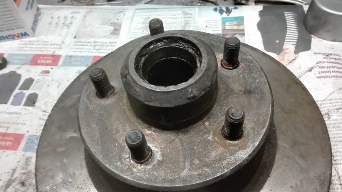

    Thanks all. Tonight I have replaced the studs of the left side.
    The outer cone bearing shows some wear, but the bearing races inside the rotor seems shiny. I have ordered parts for both sides of the vehicle to be sure. Tomorrow the bearing and sealing set would arrive.
    I assume that it is normal for the nut of the wheel hub(fix bearings) to be hand-tight?
    For me the best option was to order the wheels from Europe. I have ordered a steel set of 7x15 rims. Then the car will drive around again soon.
    Yes I did also like the aluminium style wheels. Too bad that a broken one has gone. But good to know it is an mopar type wheel. If someone is interested in the rims you can ask me.
    If I am close to the car in Belgian, I can always sniff around for stuff.

    The way I’ve done it for decades is: sung up the nut, rotate the brake rotor/hub a 1/4 to 1/3rd a rotation (to get bearing rollers into position). Tighten the nut tighter (need a wrench for this) and rotate the rotor again (1/4 to 1/3 a turn) and tighten again (again with a wrench- but not very tight) and rotate one last time (rotor should be rather difficult to turn at this point). This gets the bearing rollers into position it needs to be at, or otherwise your wheel bearing will be “too loose” after driven a short distance. Then back off the nut (using a wrench) a ½ turn (or so) and tighten it to just a scooch tighter than finger tight (and absolutely no tighter).
    My friends tell me the 3rd tightening sequence is not necessary (which might be true) - but I haven’t had any problems using it this way.
    When you get the wheel installed and lugs tight and with tire off the ground, there will be a bit of play side to side, top to bottom – which is just barely noticeable, which is exactly where you want it to be.
    If you can’t feel any play, then wheel bearing is “too tight” and will experience failure sooner than one wants.
    If too loose, the front end of car (steering and suspension) will feel “loose” when driving.
