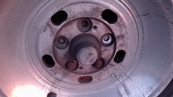

Got an serious problem here. Three struds from left wheel hub are broken. Lucky I notice it in the morning on low speed road. I think one is gone by corrosion and, destroy the other ones.
So I can bore out the hub and make new struds. But I don't want to mess with this part. To get the struds fit right.
Can't find an seller for these front wheel hub. It is one with 5 struds type.
Thanks

You just need new lug studs, they are press fit from the backside of the hub. The hub itself is also the rotor (unicast), and listed as such. The studs are available from a bunch of suppliers
3,179
820
Looks like it's been do for service for awhile so pull the rotor replace studs, pack wheel bearings and service brakes if needed.

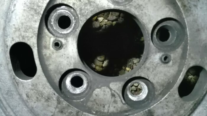

Only it seems that the left rim is unfortunately broken ... This is made of aluminum and the relevant holes have become oval. Also with the rain heard the rim a little hiss.
After replacing the studs I could drive on the spare tire. But I think I should look for a series of new rims. The current tires are 205/75/15. I could put a series of steel rims on it. But look what's for sale.

Yes definitely find correct steel wheels. That wheel you have will keep breaking studs.

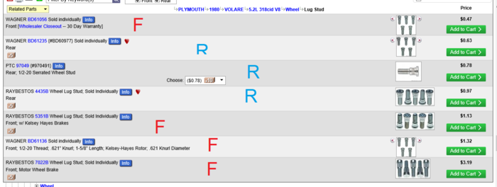

1,494
The lug stud part numbers are listed (below). This is from RockAuto.com – but using the vender name and part number – you should be able to find something.
With a press or a large C-clamp, the lug studs are not too difficult to replace (I’ve replaced hundreds of them (or more) before.
If desperate, a person can use a large nut, and use an existing lug nut to help pull the stud through – but it is hard on the stud and destructive to the “large nut” and to your existing lug nut (a press or huge C-clamp is much easier).
Before replacing any studs, be sure to remove brake rotor from car and remove wheel bearings from existing brake rotor/hub. The bearing races inside of the rotor/hub should be shiny, with no scratches or discoloration. If bearing races are not shiny, then you would be better off getting a replacement brake rotor (and new wheel bearings).
Most people forget a person needs to clean and repack our FMJ front wheel bearings every 30k miles (48k km) or during every front brake job (which for most people is also every 30k miles) – or you will experience wheel bearing failure. It is no fun driving, hearing a noise, then seeing your front tire continue down the road while the rest of car grinds to a sudden stop on the road.
I like that style aluminum wheels – which only came installed on early M-body cars. It will fit most all of Chrysler vehicles made in that era. I would not trust your damaged wheel trust because of the damage from driving car with loose lug nuts (from broken studs) – but it might be repairable with someone who can weld and re-machine back to specifications. I hadn’t heard of that process being done before – but in theory it should be doable. It may be easier and cheaper to find a replacement wheel (or wheels).
