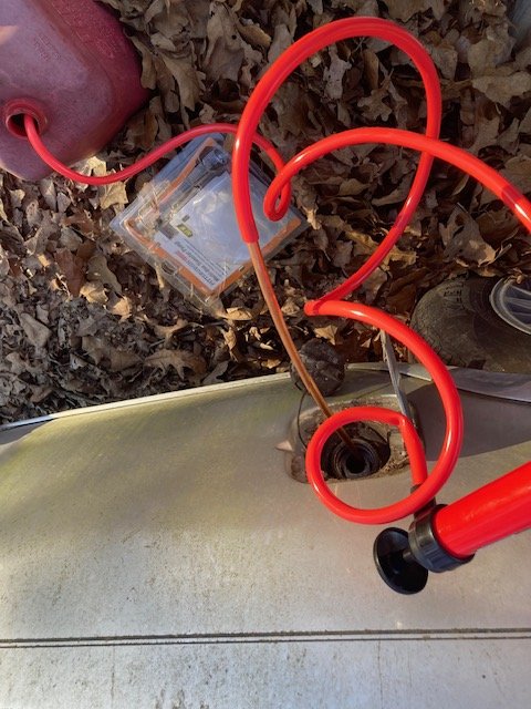

Found my manual transfer pump and with the cast off 4'ft copper tube I scored at the hardware store was finally able to get 4 gallons of gas out of the Fifth Avenue. This is more commonly known as "PROGRESS".
Let me get the picture resized and I'll upload it tonight. The reality of 'delaying laundry duties til this week' means I need to get some done before tomorrow a.m. so pics have to wait til tonight.

No, I was not standing on top of the car when I took this shot. Weird angle though.. must have had the phone upside down. I said a special thank you when I found this manual transfer pump buried among the other items in the garage.

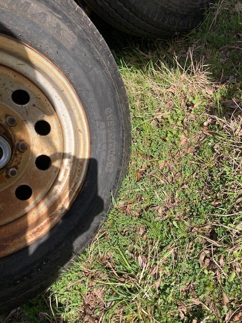

And of course, no day is complete unless you loan out your dual axle trailer and it gets returned with two flats. So I'm buying 2 more freaking tires. Which makes a total of 6 tires this year and its only March.

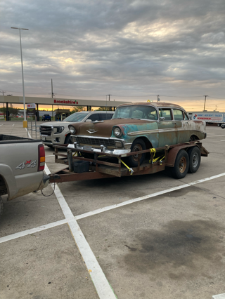

Here it is in the parking lot at the grocery store on my way home last night.
