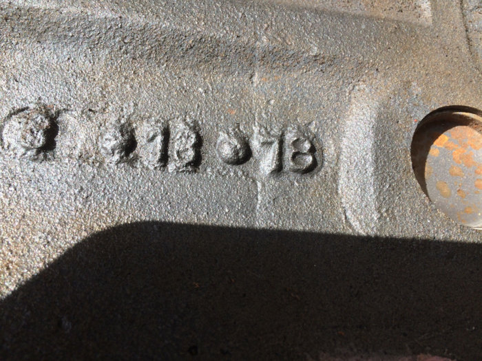

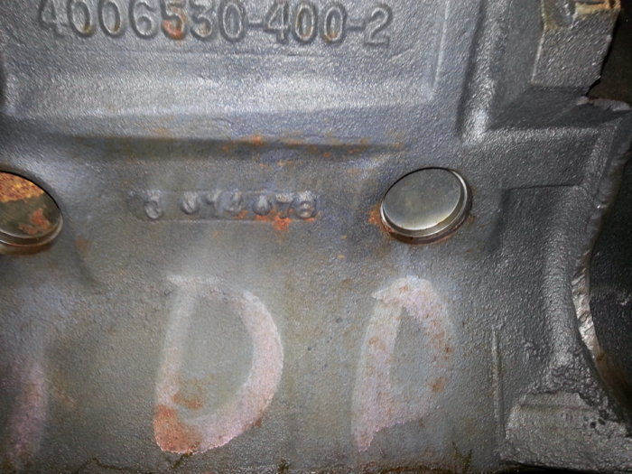

I have two new (NOS) Chrysler 400 short blocks (with cast cranks). One with cast date of 3-13-78 and other with a cast date of 3-14-78.
I also have a two pair (4) of 440 Source Stealth cylinder heads (aluminum), Aluminum water pumps/housings. A pair of 440 Source stroker crank kits. Two sets of Diamond moly/ceramic coated pistons for a stock bore 400 (I just can’t face boring out brand new blocks).
The blocks will need to be taken and cleaned before I can work on them (still coated in cosmoline) and haven’t decided on camshafts yet. Still in parts gathering mode.

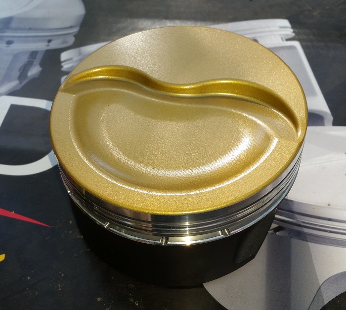

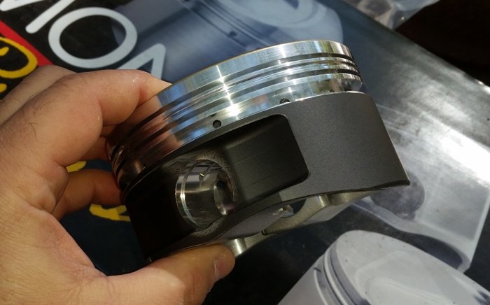

...A pair of 440 Source stroker crank kits. Two sets of Diamond moly/ceramic coated pistons for a stock bore 400...
I picked up a set of Mahle pistons (#930271030, 408" stroker setup), which for now are sitting in the box.
As I have been gearing up for the stroker W2 build I often pondered the coatings approach. Haven't gone anywhere with it because just everyone around my area here thinks that's a waste of money. I belive that is not the case, but I do not have any empirical evidence to suggest I could turn that investment into added value.
In other words: would coating pistons and the head chambers allow me to run a slightly higher static compression without the danger of developing hot-spots and therefore detonation?
Or perhaps the benefits are mostly from capturing the heat in the chamber so that more of it can be converted into kinetic energy, thus more push to the crank? And if so, what does that actually translate to as far as power increase %?

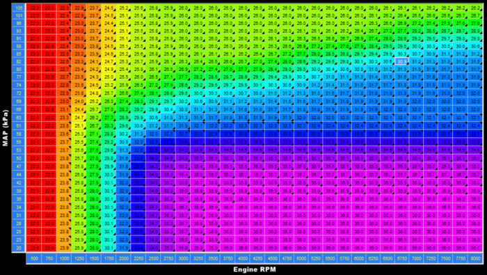

EFI doesn't need to be easy. You can let computers do everything or you can go balls deep and set it all yourself. I was making timing adjustments to the car in a Home Depot parking lot last summer. I'm not talking about base timing, but the actual timing curve.
Do this with a mechanical distributor:
Same goes for the fuel map. Endless adjustability in real time. No cracking the bowls to change jets. No tearing apart the dizzy to set it up in a machine to set the curve.
In your case, what did that coating cost you?
I ran a set of coated Speed Pro pistons and never had issues, but I've seen photos of where the coating peels off and plugs up the oil pickup. That being said, stroker pistons are like hockey pucks and don't have much of a skirt. Don't think a coating would do much with those. Can't speak to the cylinder heads, but I don't see cylinder head manufactures doing it from the factory.

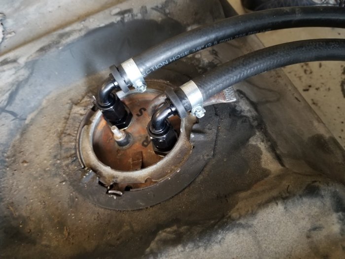

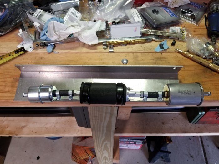

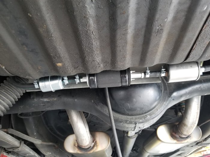

So I was curious,for those running EFI are you guys running a in-tank fuel pump or external pump? I know a in-tank is quieter,(runs cooler maybe)? but, is there any other advantages besides this and not having to mount a external pump,different pickup etc.?
Mine is external and it is what was provided in the master kit with my Holley Sniper. After the initial prime, you never hear it. That being said I will be moving to an in-tank setup next year. Unless you setup baffles in the tank you're going to run into times where the pickup becomes uncovered and the system sucks air. This happened to me at the track with a 1/4 tank of fuel. Anything under a 1/4 for me and this happens in normal street driving. I even modified the pickup to 3/8" tube and extended it. If I have to go into the tank to make baffles, then the pump is going in as well. It's a cleaner installation and there is really no good place to mount an external as it has to be below the fuel level.
That being said though, here is how mine is mounted now:
With an 8.75" there actually is enough clearance between the mounting plate and the differential. Not so much my D60 now.
The plate is aluminum flat stock bent over using a break and attached to the bolts coming off of the straps that held the old splash shield. Not really pleased with this setup either. Another reason to go in-tank.
The right angle high pressure fittings in the pickup do not clear the trunk floor either. I had to space the tank down making shims out of thick rubber. New in-tank setup will have a depression built in to accommodate the plumbing.
I don’t remember what they cost me - but they weren’t cheap.
I purchased two sets (one for each NOS block) and they sent me three extra pistons. They said it is not uncommon for one or two not to get machined correctly so they cast/machined spares. In this case, all were fine, so they sent me the extras. If I recall correctly (no guaranty of this) it cost me $1,350 (US) for two sets of moly coated (sides) and ceramic coated (tops) with rings, in October 2015, from Diamond Pistons Home | Diamond Racing Pistons .
Unrelated, the 440 Source stroker crank kits came with pistons and cost wasn’t much me less to get them, or not. The 440 Source piston sets are $600 (US) – and they require a person to bore out the blocks to fit. I see no reason to bore out a perfectly good brand-new block – especially if I plan on driving them for a long time into the future.

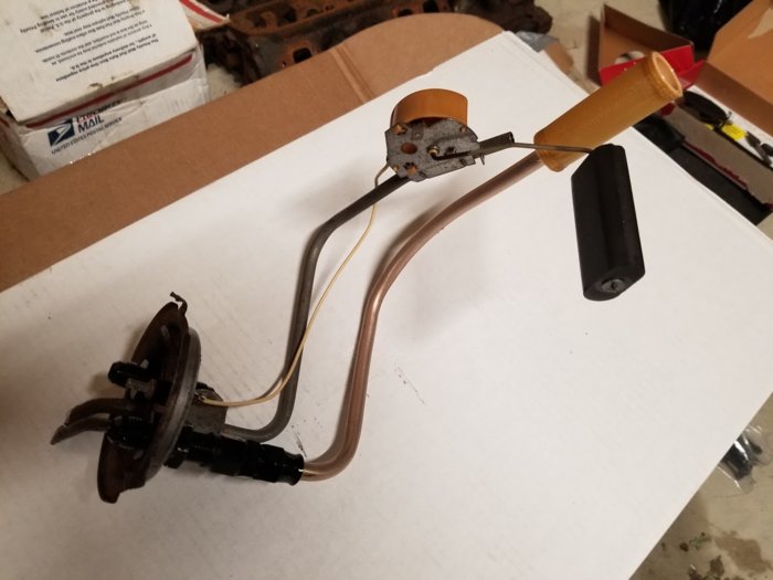

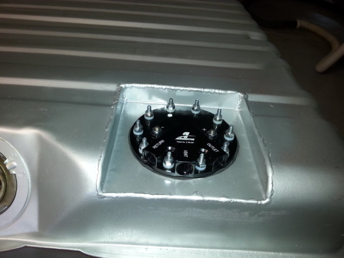

As to which fuel pump, I researched this a few years ago and this system seamed like the best for me The Phantom – Aeromotive, Inc .
I am planning on going with new fuel tanks so take new tanks and get a bracket welded in like this:
