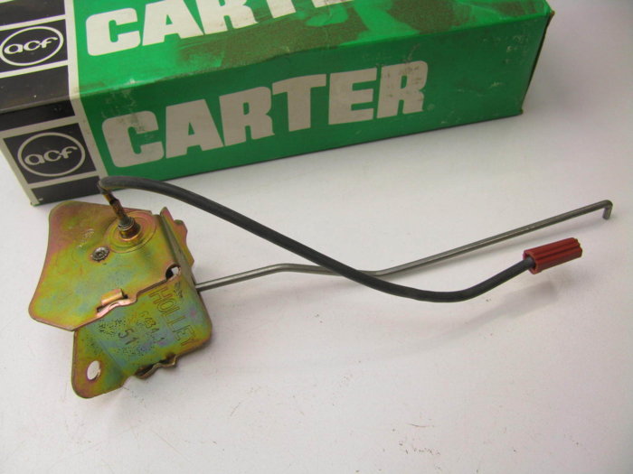

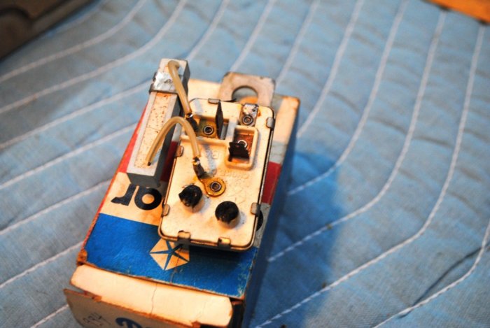

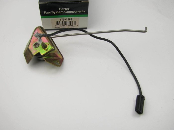

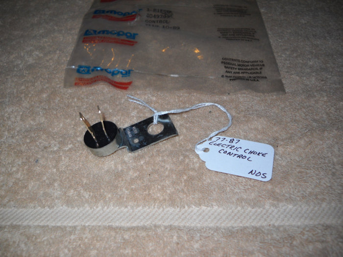

If the choke thermostat is 10 to 15 years old, then replace it. There are many for sale on eBay, if your local parts store does not have one. The bimetallic spring on the thermostats seam to rust and just quit working well after 10 to 15 years.
1-bbl version
2-bbl version.
Make sure the choke thermostat is hooked up to a power source like this one. If it is missing or unplugged, then fix that (as well).
This is one of four different versions. The other version pair is about ½ this size, is round and is black (instead of white and rectangular). Both versions have the resistor on its side (or not).
All pictures were swiped from eBay.

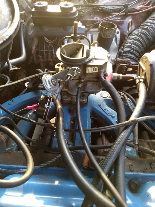

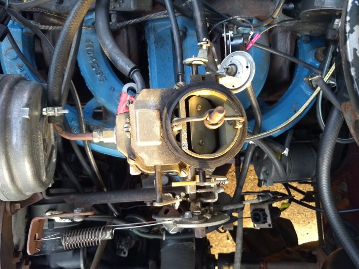

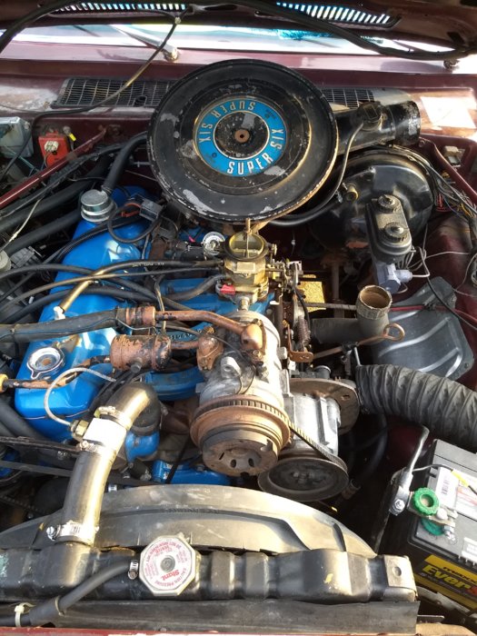

I have a Slant Six -- and have been putting some brain cycles on your problem. In your other post, you have an under-hood shot. It's clear to me that there has been lots of tinkering under there, and several systems are missing. In particular, the carb heat systems is missing. I can tell you that having the correct temperature air coming into your carb (in this case, 90 degrees), is critical to having the car drive correctly. During warm up, the choke system provides the rich mixture to allow smooth driveability, and upon warm up, the carb heat system provides 90 degree air to the carb so the rest of their systems can do their thing. The carb heat system is: The heat stove on the exhaust manifold, a piece of flex pipe that goes up to the air-cleaner horn, a vacuum operated flap on the horn, and finally, a thermactor on the air cleaner that measures temperature. The thermactor varies the amount of vacuum going to the flap on the horn to keep the temperature in the air cleaner at 90 degree. It's seems like such a little thing, but indiscriminately ripping off "emissions junk" will often result in driveability problems if one doesn't know how to compensate for it. If you could find a donor vehicle, putting Humpty Dumpty back together again would, I'll wager, solve many of the problems you're having. Barring putting it back to factory specs -- You could also consider "starting over." Get yourself a new 4 BBL intake and small carb... Or you can just do this: Slant Sickness! How To Add 77 HP To Your Mopar Slant Six! - Hot Rod Network
Cordoba1
Nov 22, 2011
459
128
Northern Illinois
BudW also noted the missing OSAC valve. That very-possibly could be the cause of your ping... Because, what it does is delay vacuum advance for roughly 15 seconds (depending on temperature, that is why it is on the air-cleaner.) Your distributor is getting an advance signal earlier than what the timing curves were designed for. If you could find a Slant 6 in a bone-yard, go part shopping. BudW ALSO pointed out the the choke thermostat and resister -- also very important! The "little black box" is an electronic thermostat. It provides full voltage to the spring to assist with choke pull-off. The resistor provides a lower voltage once the thermostat shuts off to make sure the spring doesn't cool off too much and re-choke the engine. All these things work together to make your engine happy. My Slanty didn't run right until I got the heat stove and electronic choke pull off working correctly... When I presented the parts to the check out counter guy at the bone-yard, they sent me on my way without charging me. By way of PS -- The electronic choke thermostat, the OSAC valve, and the thermactor were used on V8's, too, so the parts don't have to be from a Slant.

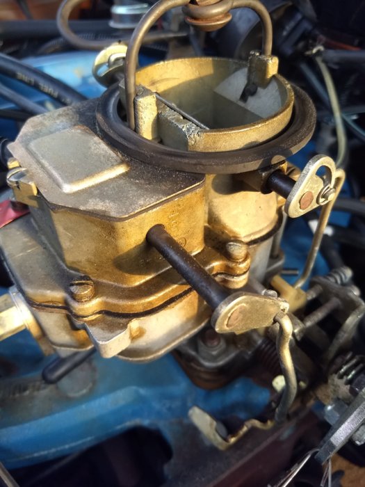

We got the carb in a bubble of air formed by the plastic it was in, with a cardboard base. I'm going to assume standard jets and equipment for a super six 2bbl.
The engine was rebuilt. We milled the head and bored a little. Plus a very mild cam, nothing crazy. Compression was obviously increased a bit.
We decided to convert to the super six package, which we did. Had a rough experience with a gasket, but we fixed it.
We changed the choke, to an updated electric choke. New temp controller.

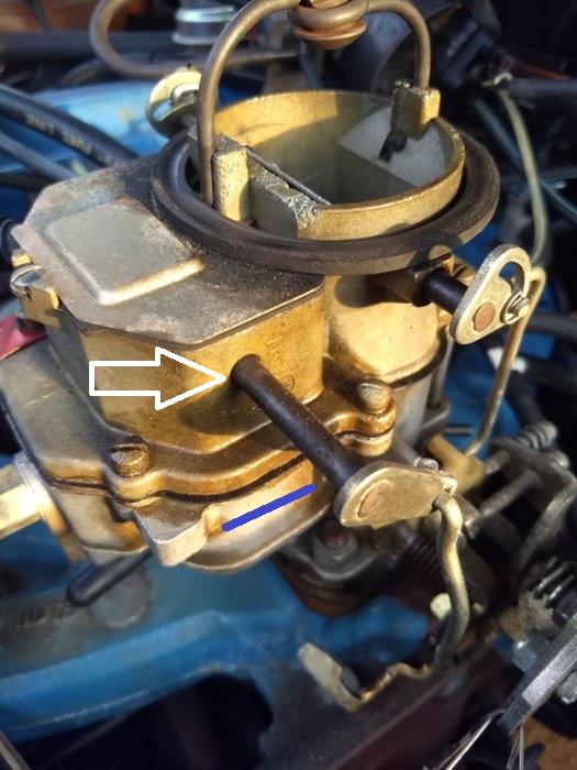

We cleaned the carb with carb cleaner, spraying the outside and inside a few weeks ago. It seems to be leaking from the rod leading into the top of the carb. I don't know the exact term, but there is a picture.
Just standing next to the car, I can get a wiff of gasoline, hood shut and everything. I'll assume it's a combination of running rich and the leak.
Everything that is on the car was there when we got the car, aside from a make shift heat shield for the carb.
Summer's rolling around, so gas mix is going to change? I've got a bit of knocking under light throttle, on flat and up hill.
I'm going to re-time it based on vacuum, and retard untill no knocking. Then look into vacuum advance. Tune mixture and set final idle speeds.
I notice the idle speeds did get lower since the last tweek, but I'll assume that's just things settling in? We didn't put the gasket back on for the distributor, but I highly doubt that's causing any harm, asside from seepage.
1,492
A Carter BBD.
Do you mean the location indicated by the white arrow?
If so, the fuel level is way too high.
The fuel level should be around the blue line (above).
Matter of fact, you can remove the carburetor top with base and body still on car (without any fuel leakage/spillage), if you wanted to.
Get the fuel leak fixed first, then go back in and reset idle and timing (for it may affect the other settings).

No gas should be leaking from up there. As stated remove the cover and check the function of the metering rods. If needed, those rods can be adjusted but I would search online for the correct procedure. Maybe some dirt is in the needle and seat causing issues also.
1,492
I wonder if some trash is keeping the needle/seat open, or something like that.
You said this carburetor is how old or has how many miles on it sense last rebuild (or new)?
