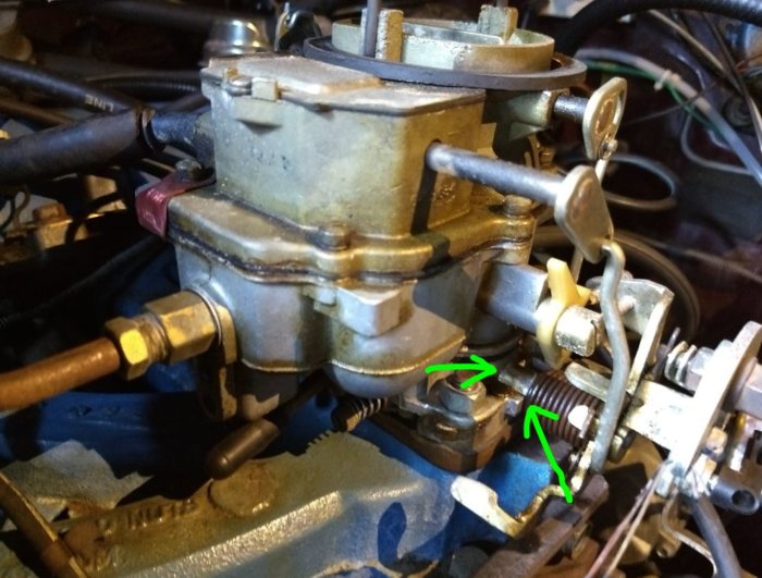

The_red_barron and I found (just now) that after being run and then parked, and as the engine heat soaks, there is fuel dripping from the butterfly rod at the bottom of the carb onto the exhaust....NOT GOOD. Looking in the throat of the carb, we could see fuel squirting out as it just sat.....from the heat.
Would a "cool carb" plate help ya think?
I cant figure out why there would be fuel dripping from the butterfly rod.....only doing it when sitting after being run, and only for a short time...but enough to make me worry about fire...
Leaking from the shaft at the body as shown in the picture and then traveling along the spring and then dripping....at the rate of maybe a drop every 5 seconds or so....we took the air cleaner off and then within a minute or two it stopped altogether.

But just wondering, if its a high float or needle/seat issue, why does it do it ONLY after sitting and only for a short time like it does?
I agree carb issue like sticky needle & seat, dirt or high float level. Make sure the floats are not full of gas( leaking).
BTW, the throttle shaft on those carbs tend wear over time and cause vacuum leaks and seepage. They can be rebuilt properly by drilling and installing bushings on the shaft.
I have run into those issues before on other cabrs, but the problem is evident at all times....this is only happening when HOT and only right after shutdown and it stops as engine cools.
Is it possible (advisable) to pull the top half of the carb off to get to the floats and check for dirt in the bowl without pulling the whole carb off the manifold?
Yes it is, but look at your pic, that gasket looks soaked as hell so you might do well with a spare.
I think its just a couple linkages, like the choke, pump shot rod, then the round robin of screws.
You could then check your float level and the condition of your needle and seat.
It can be a bit frustrating, so you need to know where you float should be prior to pulling it apart, too low and you run out of fuel when hard on it, too much and your dumping fuel.
Alot of thos 2bbls carbs there if not too far off wont leak much or any while running but just dump the fuel.
You might look on ebay for a cheap kit and float and simply go through it and that would eliminate alot of possible issues and ensure a good carb for a while.
I have a rebuilt 318 carb just like that but I`m pretty sure they are different for the 6cyl. Anyways, the top comes off pretty easy but as said the gasket most likely will need to be replaced. It isn`t really that much more involved to remove the carb. The base gasket looks like the thick one so that helps with heat soak. To set the float it would be best to have the carb off too. The rubber on the needle and seat can get hard and not seal/seat well also.

You got to go into this with a semi open mind, id just get a float, a kit and 2 cans of carbs cleaner and figure out when you can spend two hours on the car.
Id not be concerned about the shaft at this point as even if it did suck a hint of air which its probably not you can adjust it out via the air screws.
If its that important and there is no time there is always the option of a local shop to drop it off at while one is at work or school but it would be a waste of a couple hundred bucks or so. That carb there is as simple as they come.
If it were mine and I was really pressed for time id just pull the top, change out the needle and seat and install, set the new float and put the top back on and that would address the leaking, but the bottom gasket between the baseplate and body is one that can always stand to be replaced.
No matter how you do it, the fix is easy.

If you fix the float/seat issue it wont have gas leak from it, the shaft does not run through a wet bowl, it leaks fuel there now as it can and the rest goes down the intake manifold.
