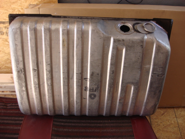

I have a NOS one thats not perfect either for my other car. I had two and sold one some years back. Now I wish I would have kept it. The other side is not horrible and has a few small dings. I`ll see more when I get the rest of the paint stripped off.

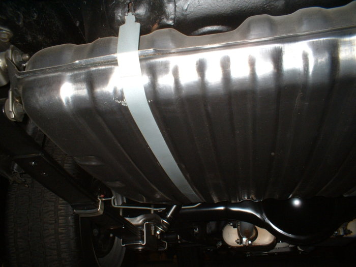

Even if there was new '76/'77 hump tank made, the replacements have a different finish than originals anyway I think). It's not really galvanized but more aluminized appearing. This is the one in my car, a new Spectre that I put in during "the build".
The camera flash kind of ef'd it up but you get the idea. The only thing I did was clean it good with wax and grease remover and gave it a couple coats of Eastwood satin clear for bare metal paint to keep it from oxidizing. That was over 5 years ago and so far, it's holding up very good.

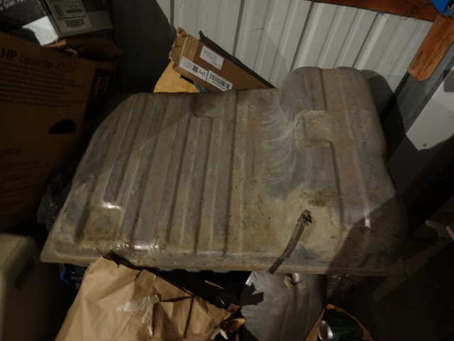

I forgot I had another humper in my junk pile, I think I might try to soda blast it with low pressure and see if it looks oem.

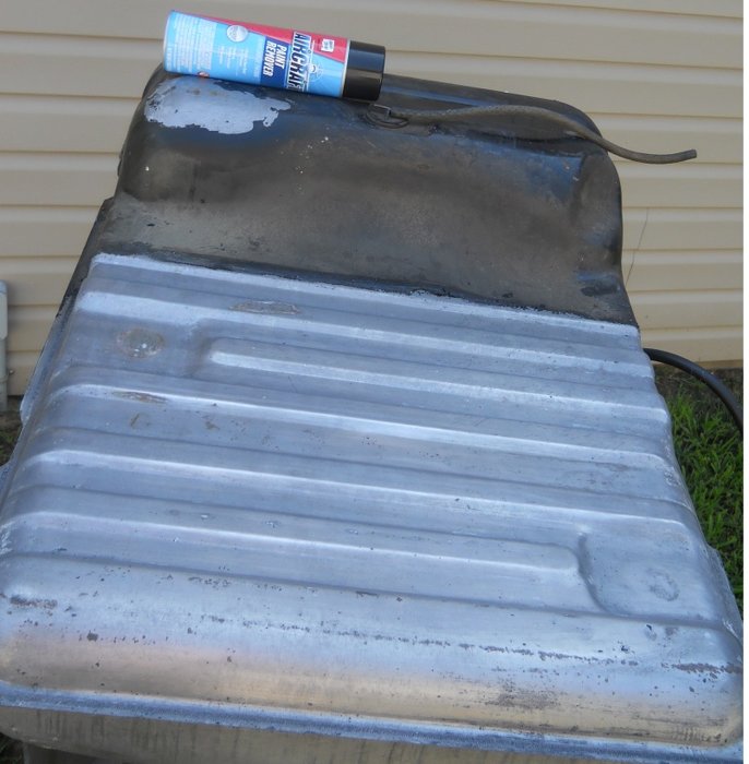

Seems to be cleaning up pretty well with some steel wool. I may just clear coat. I have some PPG clear coat but I would like a matte finish.

Btw, I ended up painting the tank because I fixed a couple small dings which i couldn`t do if I just clear coated.
