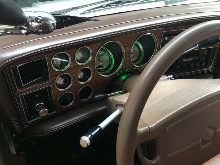

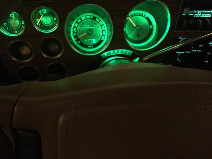

I got it right this time. Used green LED bulbs instead of white so they don’t wash out the color. Looks like stock just brighter. I’m so pleased with it. This is full brightness.

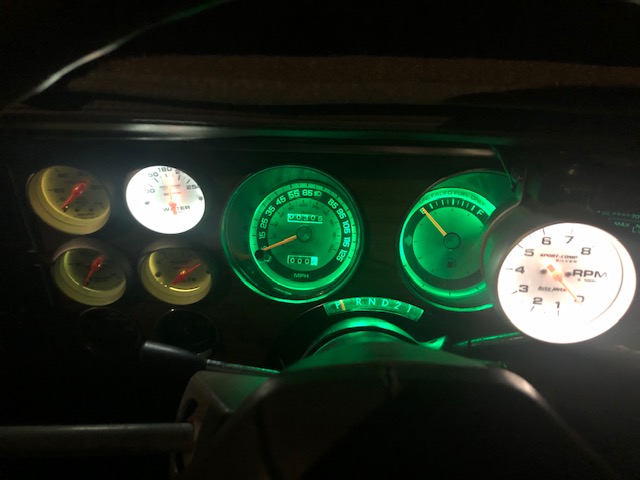

When I was replacing my light bulbs with LED's I decided to do some testing to see the difference. Green LED wedge bulbs for the speedo/gas, the tach and temp had cool white LED while the rest had the regular incandescent. Soon after I replace the remaining bulbs with cool white LED's, what a huge difference in visibility. Even though they're really not able to be dimmed if you wanted to.
Wow, I like that! One of these days when I finally get back to work on my wagon, I will do the same replacement with the green LED's. Very nice - Thanks for the picture!

Only downside that I've found is that you can't really dim/adjust them on the headlight switch. For me personally it doesn't bother me since the LED swap is why I wanted them to be more visible and brighter etc. Another thing that I did since the cluster was out, is take off the lenses and cleaned the insides of dust and grime that have accumulated over the last 30+ years.
