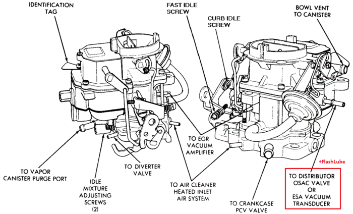

I think it's useful if I check the ignition timing.

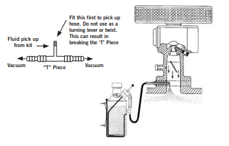

From the carburetor to the vacuum advance of the distributor, Flashlube is also sucked in.
However, the amount of flashlube is minimal. But with each time move the throttle, both the vacuum is advance and a bit of Flashlube is sucked.
Could it be possible that this affects the vacuum advance? This is not original.
I should say that the connection of the vacuum connection is incorrect.

Thanks bud.

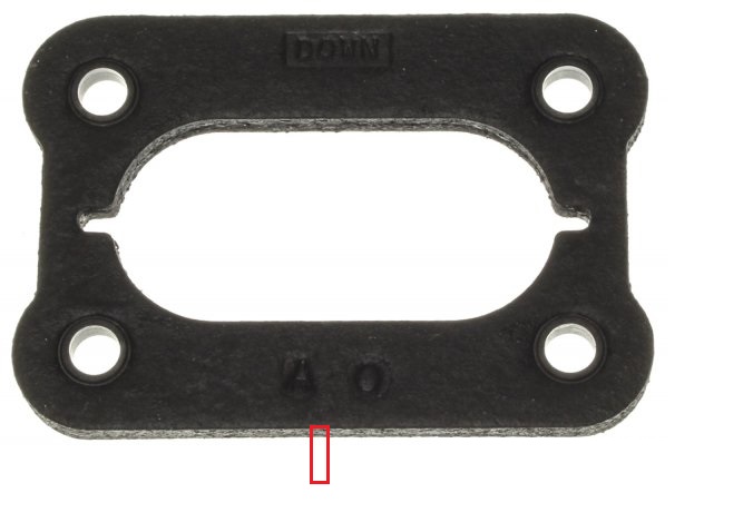

I intend to make an inlet connection for the flashlube in the older Carburetor Mounting Gasket. This is made of plastic. If it does not work, I can also make a gasket made of aluminum.
I saw on the internet that it is also desirable for this liquid to be injected for the gas valve. So two birds with one stone.

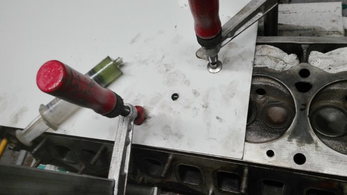

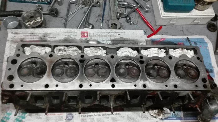

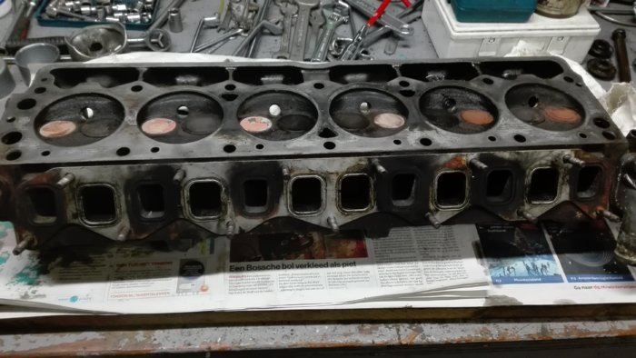

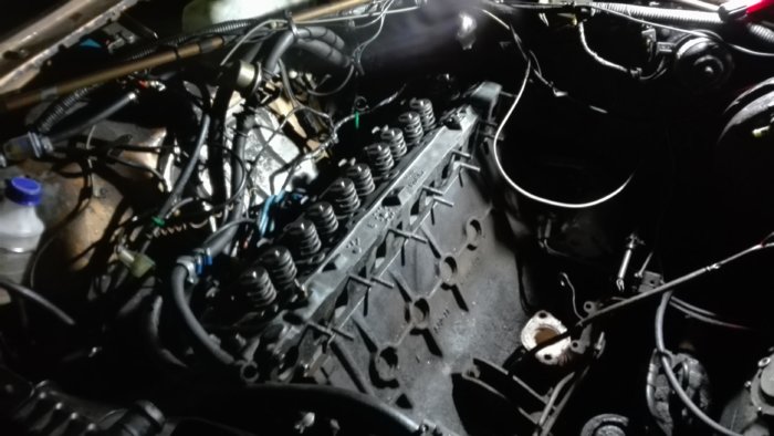

Given that I had to disassemble the cylinder head to remove the broken bolt, this offers the possibility to increase the compression of the engine. Like two birds with one stone.
I have now cleaned the combustion chambers. Especially the rooms of cylinder 2 and 6 were dirty. It is also noticeable that the exhaust valve of cylinder 5 has ever been replaced. The outlet valve of cylinder 3 seems to have subsided somewhat. Around 0.5 mm measured between combustion chamber and top of the valve. All other valves contain a size of around 1 mm. After my opinion, this is fine for many kilometers. Currently the engine also uses flashlube to protect extensive valve seat wear.

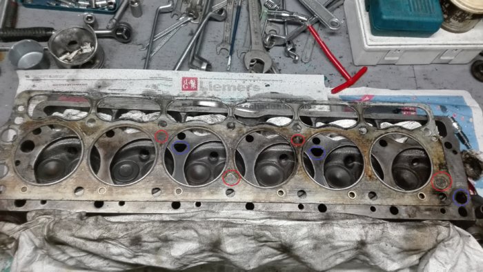

The head gasket that came off the engine is almost as thick as the new one (1mm).

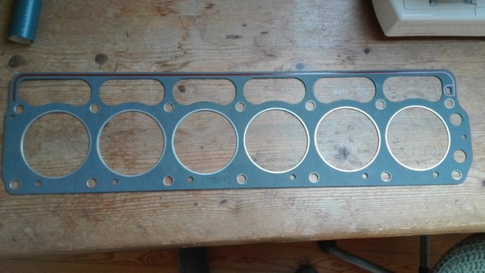

What strikes me is that in both gaskets no passage for certain cooling water channels. I have shown this with red circles for the gasket, blue circles for the head. Is this fine and has this a reason?

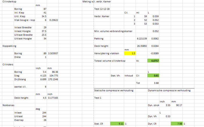

I have determined the volume of the cylinder chamber. This amounted to a minimum volume of 52 ml.
The packing and the volume above the piston (deck height) provides extra volume of 26 ml.
This equates to a static compression of 8.2: 1.
Specifications camshaft (given from internet) closes the inlet 51 degrees aBDC.
Dynamic compression contains 7.2, which comes down to a dynamic crank pressure of approximately 142 psi, 9.8 bar. This corresponds somewhat to the measured compression (9.5-10.5).
It seems that the head has been little or not flattened for this.
I'm curious which compression ratio is sensible? I would like to increase the compression based on gasoline. Here in Europe, mainly Euro 95 is common. I do not know if this is similar to what you get in the United States as 91 octane?
Later on I intend to adjust the ignition and advance curve. Possibly electronic so that I can adjust it for both petrol and LPG.
I saw a topic on this forum that fellow member had the same question. A compression ratio of 8.7 was recommended here. Can I possibly go higher?

I am maybe fast! But I think I go with a 1.5 mm cut to 9.0:1 ish static compression ratio. I think this should be a good start point to improve power and efficiency without getting get into trouble.
Today I can bring the head to a specialist in the neighborhood. And I would be able to assemble the whole thing again in the car this weekend.
This was also recommended with the available Euro 95 fuel.

Interesting to see that it is possible to increase the compression even further. But will the CR of 11.7 be paired with a completely different camshaft? I have read on another forum that it is possible to use a 2.2L turbo block piston. In combination with the connecting rods of the 198 slant. Interesting to build a block for real performance purposes. And nice to see that also with this block various adjustments are possible.
During the week I measured a certain size of the block and head. The engine has a considerable deck height. But to what extent do you get into trouble with the valves possibly touching the piston when opening the inlet, for example?

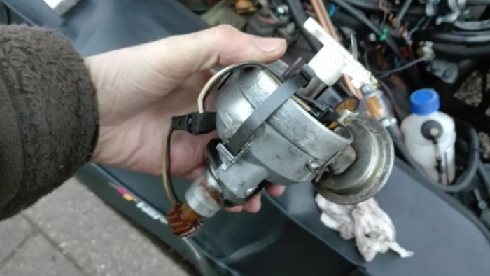

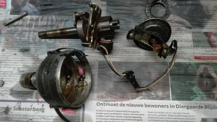

Given that the cylinder head is still at the machine shop, I checked the distributor. I could easily get it out. I noticed earlier that it looked a bit rusty internally.
The vacuum advance unit seems broken. When I suck on the vacuum connection, it does not work anymore.
This could well explain the higher consumption at part load, highway.
Besides that the Flashlube is also connected to the same vacuum line.

The distributor cleaned and put together. I am thinking to inquire about a digital ignition set. So I leave the faulty vacuum advance unit on it.

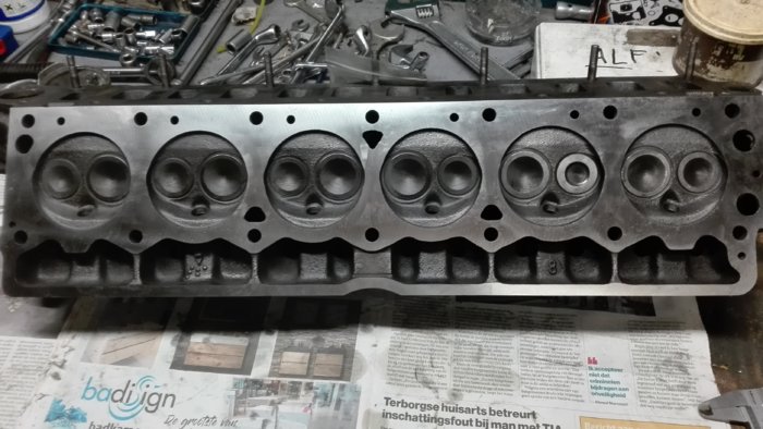

Tonight the cylinder head picked up at the machine shop. They have 1.45 mm, 0.057 inch, removed from the head.
In addition, I was told that the head may have leaked during the head gasket. After removing 0.07 mm, 0.00275 inch, the head was completely flattened. This could also see a bit of the soot between the cylinders. So this is also nicely solved.

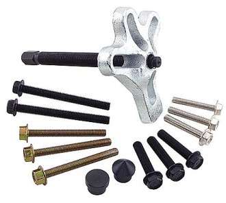

But I suppose you can easily remove the pulley from the engine with a regular pulley removal tool? Or do you need a variant that is also used for steering removal?

A person might be able to use a normal balancer tool to remove the balancer with. Install using the balancer bolt might be possible without the official tool. I do not remember installing a balancer on a /6 before – but might have (been 20-25 years ago, so memory cells are not what they used to be).
