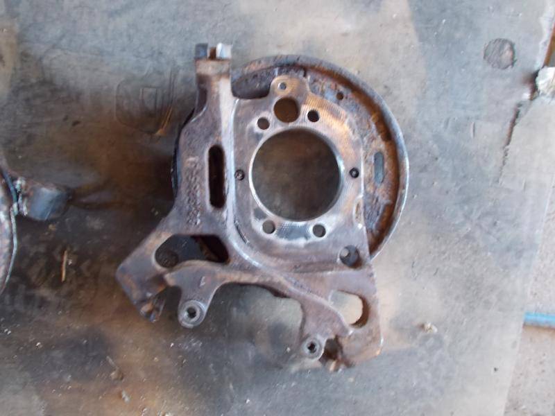

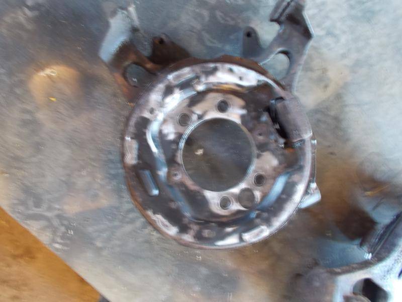

I cut away the dust shields, but left the park brake portion. The center bore needs to be slightly enlarged, I used a grinding stone on a die grinder, and the bolt holes needed a little bit of clean up. this is such an easy swap I recommend it for everyone. The jeep I got this set from was pretty clapped out.

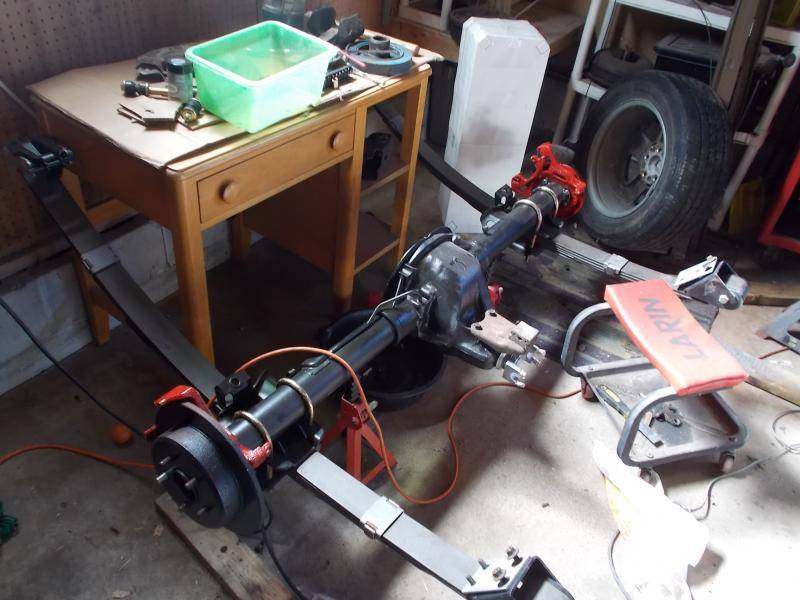

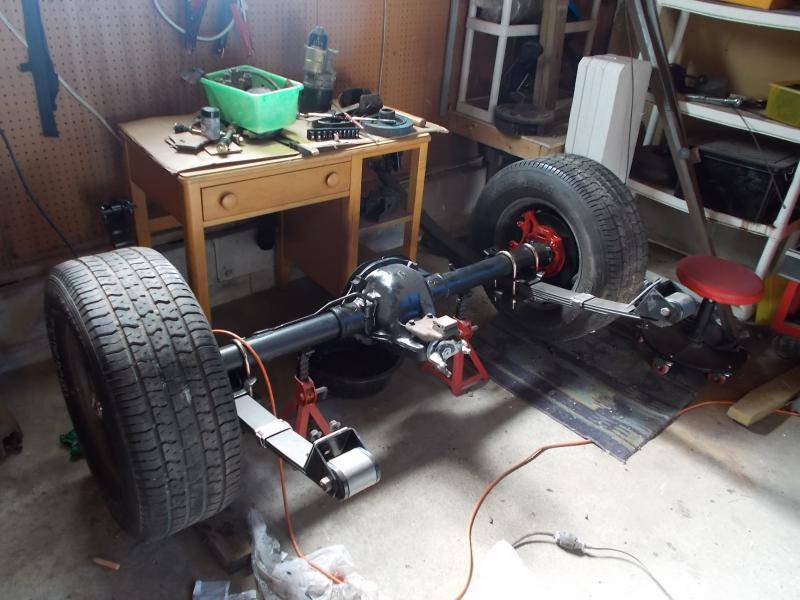

Semi-complete rear, used 3.91 gears with a limited slip, most of the Jeep brake swap, and a 7290 yoke off a 4x4 Dakota, bolted to '85 Diplomat 5 leaf cop springs, with Firm Feel Iso-delete kit and poly bushings.
Cool Beans!I have already done this swap, the bolt pattern is the same. The center hole may need some light sanding/grinding to fit the housing.
