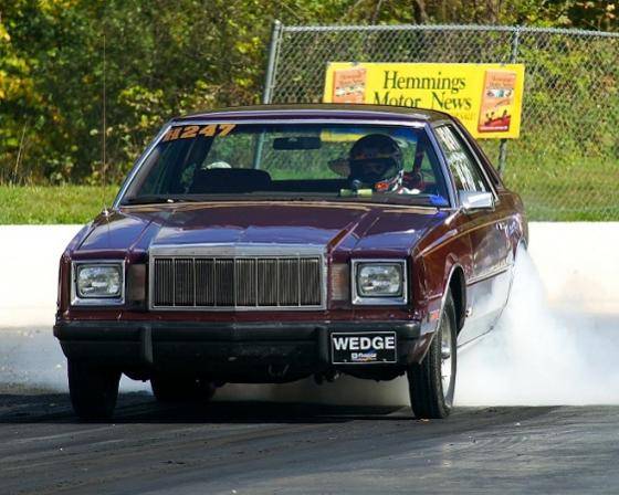

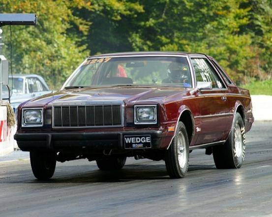

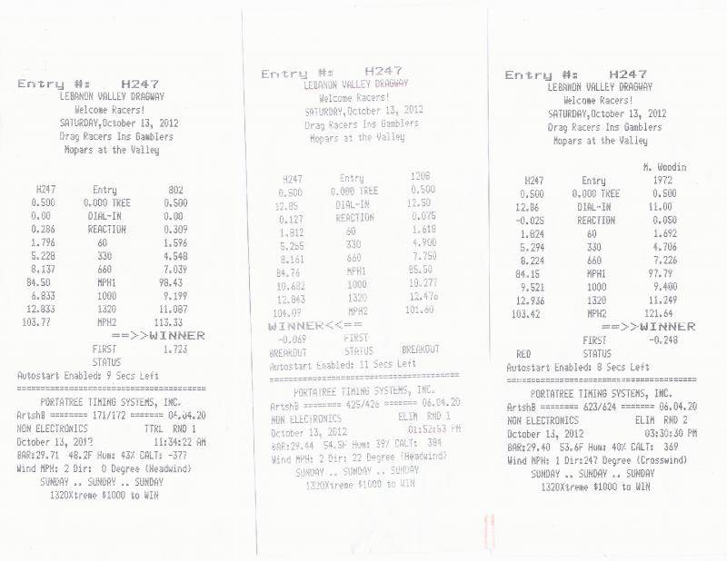

pretty happy to run 12.83 @ 104 MPH last weekend at lebanon valley,almost put the car up for sale,but,last weekend was so much FUN![video]http://www.facebook.com/ajax/flash/expand_inline.php?context=timelineSingle&max_heigh t=403&max_width=403&playertype=permalink&target_di v=uqy45wh13&v=3886376675950[/video]
