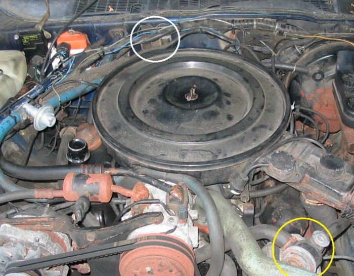

- On the firewall, there are two vacuum solenoids side by side (white circle, below). One turns the EGR valve on/off. The other solenoid (ASRV). This solenoid controls the switching valve for the A.I.R. pump (by the P/S pump). The A.I.R. pump sends air all the time but depending on temp of engine. The air is sent to exhaust manifolds or sent downstream to the rear catalytic converter. The firewall mounted solenoid or the A.I.R. pump mounted switching valve (yellow circle, below) can both make noise, sometimes – but unless there is a good-sized vacuum leak, they are either on or off.
