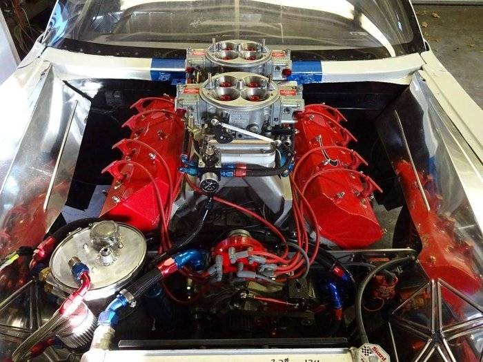

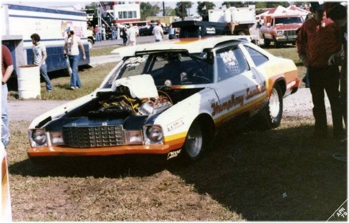

1,492
engine appears to sit quite high on both of these installs.
To me, the engine sits about the right height. The rest of the front end is sittling low (on the last one).
B and RB’s fit fine – with exception of brake booster and in some cases, the K-frame might need to be notched for oil pump (or light metal massaging with a sledge) if needed.
A Hemi would need headers to fit by the steering gear (I would think).
Would need to find some fashion for engine mounts, I don’t think anyone has made Hemi to Spool type engine mounts/brackets, yet (that I recall).
With the above issues resolved, and using a stock height intake, it should fit under the stock hood (. . . I think)
