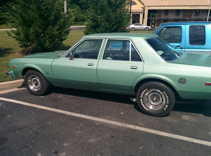

Not mine, but I saw this on vacation once years ago. I had just gotten my Volare and thought it was pretty cool to see another one in the wild. Didn't notice the LS badge on it until I was looking at the old pics a few months ago. No idea if it actually had one or not, but I think I may remember it having a roll bar and some other goodies you wouldn't need unless you were pushing out power. I know this doesn't help you much but this may very well be an LS in an F-body that someone has done. Or they just wanted to put an LS badge on their car, wish I would've realized it and looked more into it at the time.
