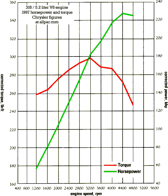

@AJ/FormS, the above chart is for a 1997 318 which would be a Magnum and they do flow more CFM than a non-Magnum 318 does - BUT that is a minor detail as to what you are trying to say.

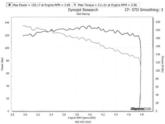

This is an older thread that I thought I'd bring up: Second time entering into a Car Show.
The rated torque converter stall for my car is 1700-2000 RPM - so not sure why they started measuring at a higher RPM. Either way, you can see the flat torque and HP curves.
Yes and this 5.2M graph appears to be from a truck engine, which has the "beerkeg intake which pumps up the low-rpm torque, as can be seen by the odd shaped torque line.
I use that graph all the time because it's handy, and clear, and clearly marked as to what it is.
I notice that they do that all the time; probably in an effort to keep the engine out of low-rpm detonation.
On your graph, notice that at the end of the test, at ~4750, she is still making 120 hp...... which is 88.8% of the peak, or down just 11.2%
I used to install a Smoggerteen into my Barracuda every winter, about 5 or 6 winters in a row until my son made me an offer on it that I couldn't refuse. That was a stock 1973 longblock, with an addition of a 4bbl and headers. Oh, and some valvesprings that allowed the valvetrain to hang together to past 5400. In that shape, she was regularly spun up to 5000, and I gotta say that the power did not seem to be all that choked up. I ran her with a 2800TC and she was a hoot!
