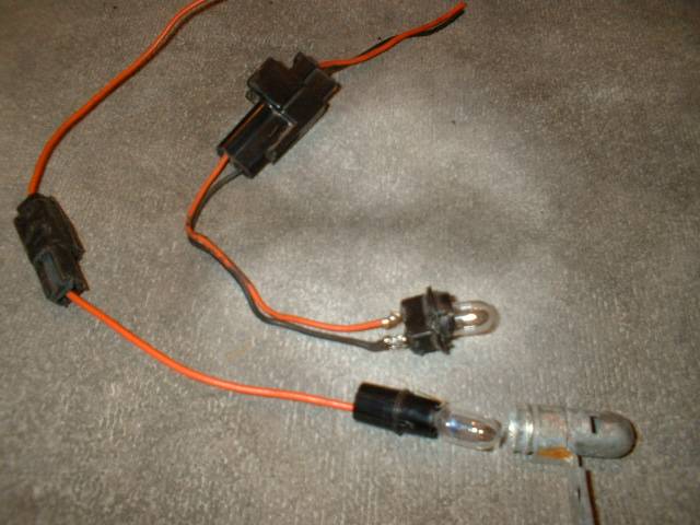

Heater Control Panel Light
Interesting, A/C and non A/C light plug are different.
BUT, if you had a connecter with the light socket, it wouldn't matter.
So instead of posts, this might work.

I have lots of heater controls in the parts dept.

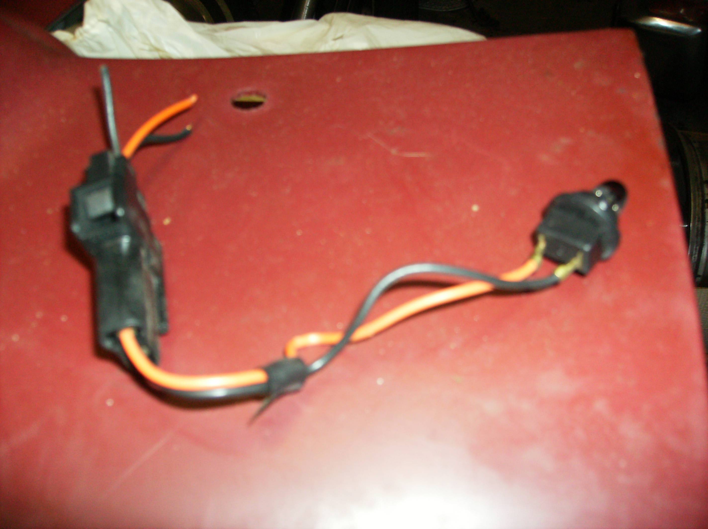

That's the one Dr. I dug through and found the same thing but not as good shape. Found an ash tray socket and pigtail also. The metal part in the pic isn't for an f-body though but might work if the mounting tab was turned 90 degrees if yours is missing. If you want them, PM me with an address.
Interesting I wonder if a side marker socket would work in a instrument panel? I mean it would not matter to me if the socket would not screw to the housing could use a little electric tape I suppose if I had too. Might not pop out. I just need something that will possibly work that will also hold a standard 194 bulb I would assume. My aspen came with AC but the previous owner removed it. Thank You.

A side marker socket won't fit the heater control, totally different style. The heater one just sort of plugs in. The one I have has one of the tabs missing but still seems to fit secure. Either me or Dr. Lebaron (I assume?) can fix you up. The one he has looks to be better condition.
