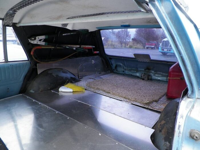

I found something that makes a great headliner, and is paintable. it is fiberglass reinforced paneling. 4X8 sheets and you just trim to fit.no more press board sagging or cloth bubbling and pealing. home depot or any big box home repair store will carry it I took my aspens old liner out smashed it flat and used it for a rough pattern. you might need a heat gun or a hair drier to help mold the corners in.

it aint a very good one. but here is something to give an idea. you might see it in places they need to easily clean and disinfect. hospitals, kitchens, restrooms, hotel lobby's ect. it has a light texture to it also.

awesome cool.
I could form fit it with a heat gun, remove it, cover it with contact cement and my foam backed lining. Glue some insulation to the backside and shove it all back in.
Very nice.
Will definitely try on the LeBaron... That headliner is hanging low low low.

I will try to get a picture of what a sheet looks like next time I'm picking up supplies. I do home repairs for a living

your welcome. theres more pics of my aspen wagon, in my hello from oregon thread, just a few posts down from this one.
you could do all that, but thats more work then needed.
this would fit just like a modern cars headliner. you could just glue your sound deadener/insolation to the roof. the dome light, interior head rails and visors will hold it in place and even help form it. and like I mentioned it is textured and paintable so no lining ( to come loose later as the foam breakes down) is necessary either.
you could litterally prep it, paint it and just install it once using the heat gun mainly to shape the corner pockets.

you will need a good set of shears, and you will want to fit it larger. then you need, just incase. it is easier to trim a lil more off, then glue it back together LOL
the trick to all things is dont get in a rush. it is basically fiberglass re enforced plastic. so it is pretty easy to work with.

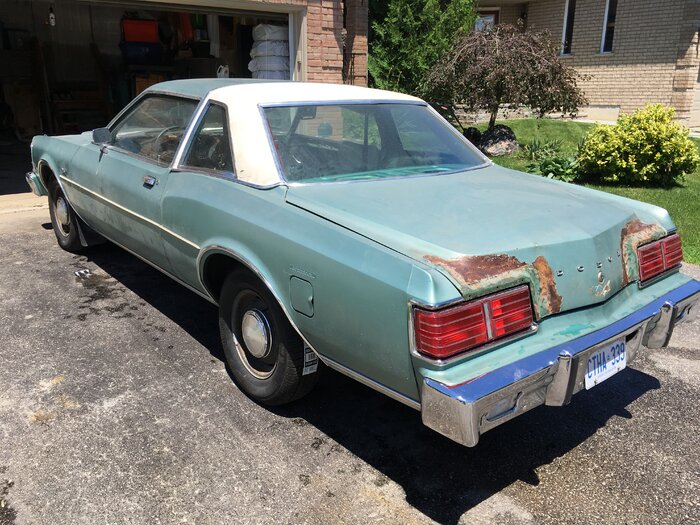

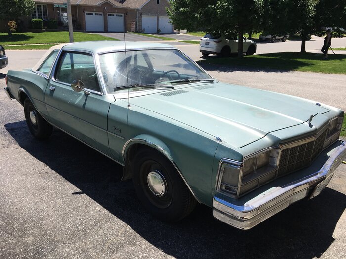

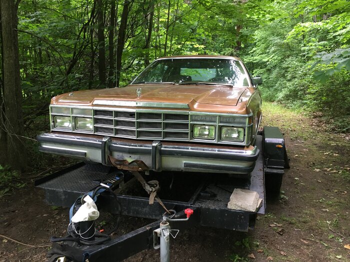

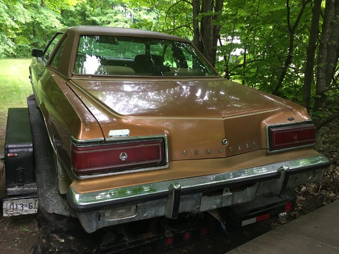

Thanks for all who voted, looks like leaving it teal has won. I did pick up some white leather bucket seats out of a '93 Lebaron convertible and they actually look good with the white vinyl quarter top, breaks up the teal! Here are some pics of the car, finally got it back on its wheels and the rear bumper & taillights back in. Oh, and last weekend I picked up a '78 2 door Lebaron parts car! You'll understand why when you see the trunk lid, I had the rear bumper, taillights, etc off because I thought there might be more body damage but luckily there wasn't. A little perplexed as to what happened to the trunk lid though, oh well have a good brown one to put on now.
