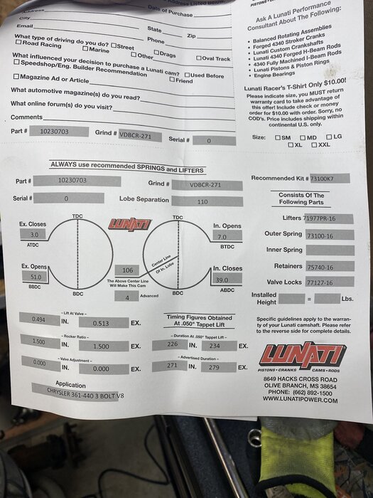

Cam is a .494/.514 with 107 lsa, 2400 converter (recommended by lunati) car will be close to 3600# and mainly street but will get stop light abuse. I was thinking going with 3.55. It came with 3.55 from the factory but the 318 had no power and cruised nicely.
I messed up on the cam specs a little bit so here is the cam card
