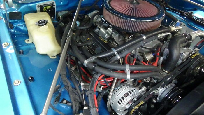

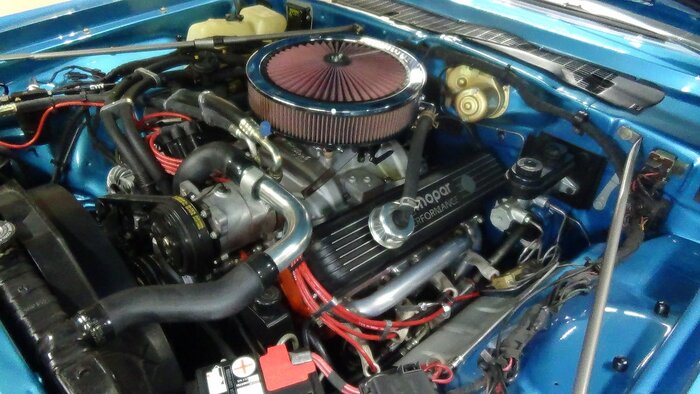

I have a 400 based 512 in my 5A. Edelbrock heads, custom headers and a mild roller cam. Built it as an off idle torque monster.
Untouched Eddie heads are a bottleneck for sure on something this size, but I built it to be mild. Trick Flow are the best all around, but aren't available right now.
My B block was a real tight fit too. Don't know what an RB is going to do.

An RB in an F/M/J is tight, but not THAT tight. They fit amazingly well. I'll admit right side spark plug access is tough though, especially with A/C anyways.
Mirada, I used a kit from 440 Source and with a .030" overbore, ends up at 500. I've got 65 closed chamber 413 heads. Have 440 size valves (Milodon SS) in them with the throats opened up, guides tapered, ports clean up and matched, and PWR SS rockers, etc, etc. The headers are (the now defunct) Schumacher "Tri-Y" ceramic coated. They it like a glove, no modifications needed to anything. Not a clue what hp and torque are other than it's more than adequate, lol. There's only one downside to it, the 8-10 mpg on premium.
