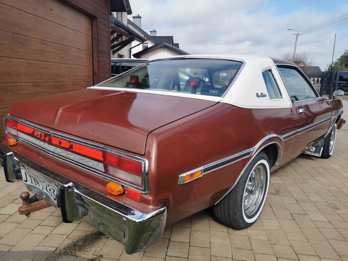

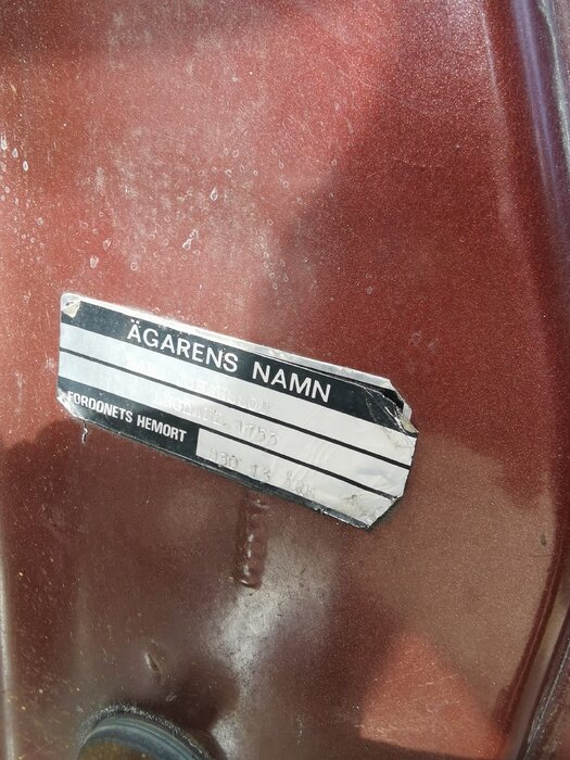

Hi! I finally got my first mopar v8 since I became obsessed with them. Wanted to buy a Duster or Dart Sport, but there was none around or in "decent" shape for a project or the import cost was too much for a rusty non driveable car. I got my hands on 77 Aspen SE 318 with landau top. The car was made for Sweden - It has a name tag of a guy who ordered it, the manual is in swedish, and it has main kmh speed unit. It is driveable and cost me less than non driveable duster from USA. I drove it home ~220miles without any problem. I was really amazed how a 45 year old car can drive so smoothly without any mechanical noises. It currently has additional turn signal lights to match with casual vechicle inspection laws, and a towing Hook along with mirrors.

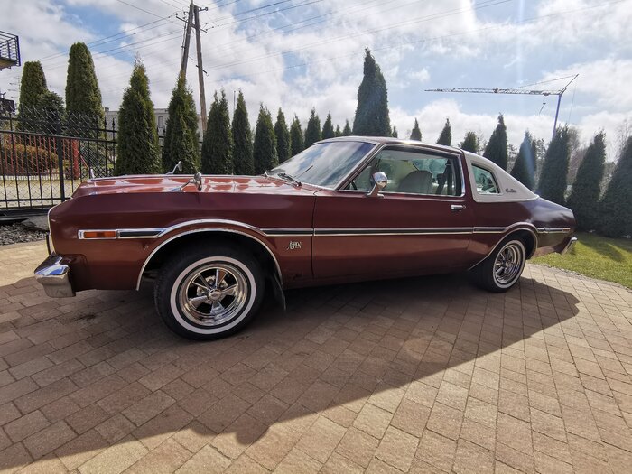

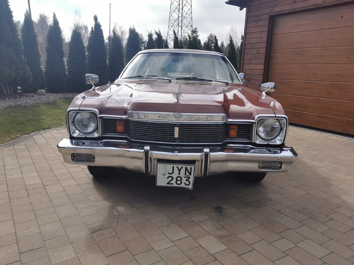

Here are some pictures from the day I bought it. Any idea how can I check if it has limited slip diff or what kind. It has a towing Hook so I wonder? From my point of view its chrysler 8.25 but i cant tell no more.

I think that is a really good looking Aspen Jed, maybe apart from the extra turn signals and fender mirrors (just my honest opinion:)).
If it is mandatory with amber turn signals in Poland, you can put amber bulbs in the front fender lamps and backup lights.
My Aspen had holes in the front fenders and some kind of rivet heads on the doors for the side molding clips, so removing the moldings will include some grinding, welding and a paint job.

Sub03- I have removed fender mirror and it looks better. I was thinking the same about turn signals to remove them and put in lower front bumper where the fog lights are (wich are currently broken) and in backup lights.
Okay, so the park/turn lamps in the bumper was converted to fog lights at some point?

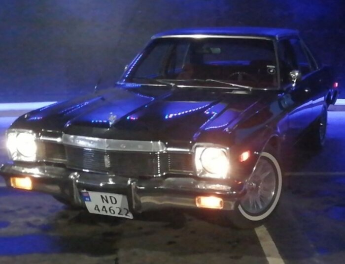

Mine had some ugly yellow plastic glued to the lenses for yellow turn signals. I managed to remove them without destroying the lens so they now have the original semi-clear look. With amber bulbs it looks like this (sorry for the low quality picture):

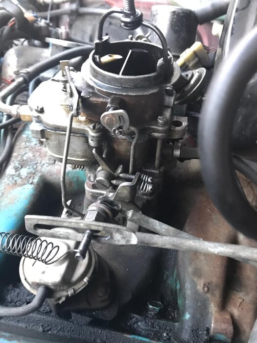

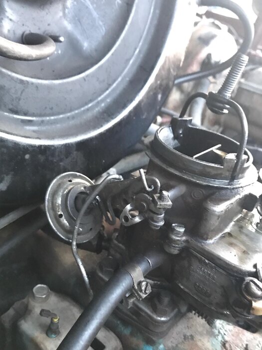

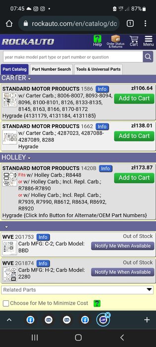

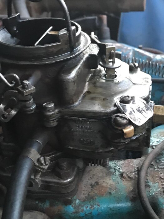

So in thinking about fixing leaky carb and rich running issue. The car burned more than 25 liters wich i think is abnormal. I started to search for lean burn engines and my "first impression" lookalike setup does not look like any of thoose i have seen on other engines but I was told it is. The car has to be started on choke otherwise it is impossible to start the engine. Currently Im thinking about deleting egr valve that I also wish to fill with steel plate. Wich gasket set from rockauto should I order? Carb is carter 2299
I want to replace intake, ignition and carb but not at this moment.

You definitely need to fix the transmission throttle lever (the long hole at the throttle, thats going down to the trans). It needs to be touching the throttle stud with its right end of the long hole.
jed_laski
Apr 15, 2022
25
15
Poland, Europe
You mean kickdown cable?
69-
Dec 13, 2020
492
347
Germany
No, it is just an adjustment issue. You have the service manual?
