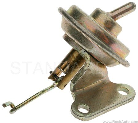

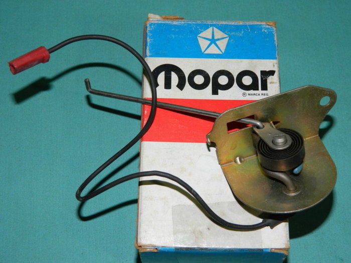

Being it is acting up when cold, I suspect the choke bi-metallic spring, the choke pull-off and/or carburetor linkage adjustments might be the most likely suspects. The bi-metallic spring gets rusty over the years and will kinda stick in a mid-position. Generally replacing that spring (or choke thermostat assembly, making sure the choke pull-off works and all carburetor adjustments fixes most cold-start issues. It is common for most choke springs to fail after 10-15 years.
Choke Thermostat

Choke Pull-off for Holley 6280 (2-bbl)

If you have a handheld vacuum pump, you can test the choke pull-off. It should move and hold position (ie: not leak out vacuum). If it won’t hold a vacuum and/or won't move with vacuum applied, change it.

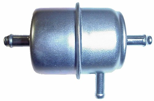

Your car should have a fuel filter with 3-fittings. Two are 5/16” and third is ¼”.
The filter is located behind the alternator and sometimes it helps to either remove the alternator or loosen both mounting bolts, remove the drive belt, then remove the outermost bolt (the small bolt with ½” head) and twist alternator up and out of the way.
The smaller hose/line sends some of the fuel back to the fuel tank but its primary purpose is to prevent “vapor-lock”. For those who not heard of that term, some engines run so hot, the fuel turns into vapor before it gets to the carburetor. This occurs more often with cars from late ‘60’s to early ‘70’s. By having a small restrictior made into the filter (at end of the ¼” fitting on filter) purges the fuel vapor before fuel arrives at the carburetor. It actually does a decent job eliminating vapor-lock – but it does also present a few other potential problems.
If the restriction on the small port of filter is missing or plugged can cause people problems.
The fuel pump puts out 5.75-7.25 PSI. It is rare for a stock fuel pump to put any more than that. Even with the filter “restrictor” is stopped up (or missing) or a 2-line filter is installed (bypassing the return line), will not affect the pump pressure amounts.
