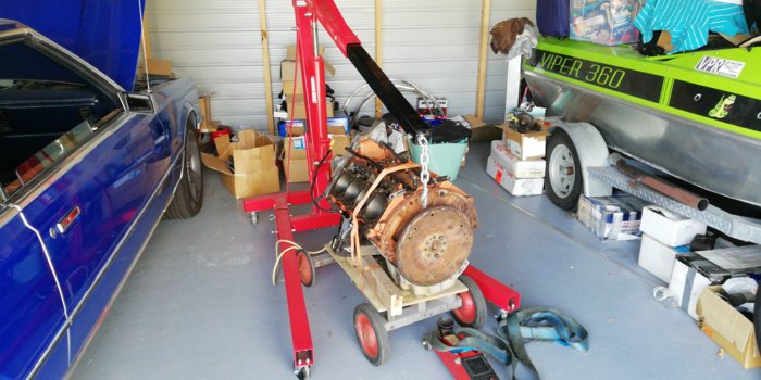

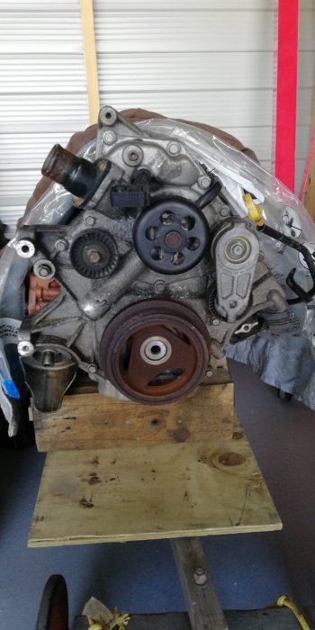

Picked up block today
The good news: aftermarket support for this is awesome! The bad news: bend over, a lot of the parts you need are going to have to be imported from the States, and are expensive even here. Looks like $2k USD in electronics alone and this isn't including any sensors you might be missing or electronic gauges/gauge adapters to boot. Between fuel system, exhaust, motor bits you're missing, probably $6k USD in parts without any machine work. What's the import taxes look like?
