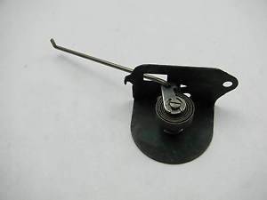

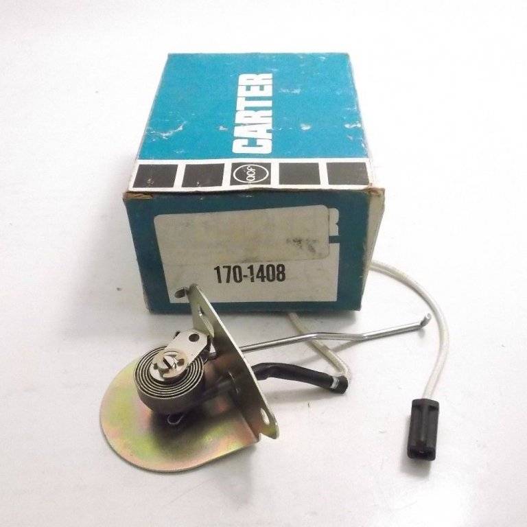

Sounds like the bi-metallic clock-spring in the choke thermostat has quit working (actually rust and age is what gets ‘em).

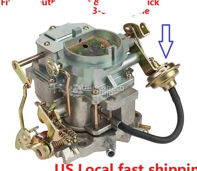

The bi-metallic spring is designed to close choke when cold and be full open when engine is hot.
The problem is as the part heat cycles for decades and rust, it doesn’t open fully (when hot) or close fully (when cold).
In my opinion, the bi-metallic spring is good for about 15-20 years of normal usage (no facts to substantiate this).
When I’m working on a drivability concern, I first make sure the choke pulloff is working.
If so, then replacing the choke thermostat fixes the problem about 90% of the time.
Carburetor Choke Pulloff
Choke Thermostat (pictures swiped from eBay)
3 ways to test the choke pulloff:
. Remove vacuum hose to choke pulloff and test with vacuum pump.
. Remove vacuum hose to choke pulloff and test by sucking on vacuum hose to make sure of no vacuum leaks.
. Remove vacuum hose to choke pulloff. Push diaphragm in. With another finger, plug vacuum port with finger, to see if diaphragm holds vacuum.
In all three cases, it should maintain vacuum (slight loss is OK) and it should move in/stay in.
I’m not aware of any method to test choke thermostat for its full range of travel – other than replacement fixes most cold, warm and hot drivability concerns I run across.
