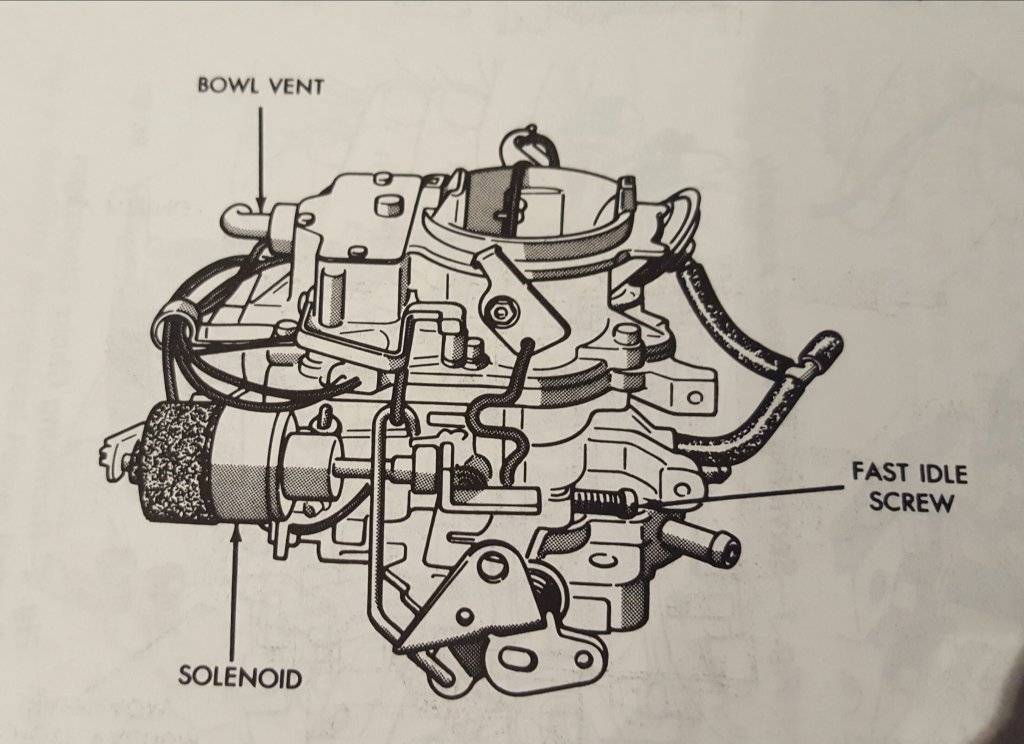

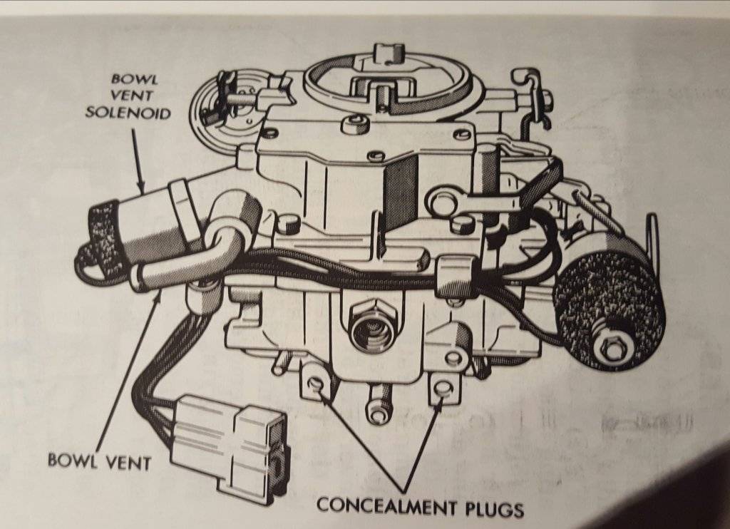

The 6280 has two solenoids
The 2280 doesn't.
As far as I know that's the only real difference.

The experts can answer that one.
I know one is for the idle. The bowl vent one I'm not that sure.

I believe the solenoid near the throttle kicks the idle up ever so slightly when the A/C is turned on. Don't quote me on it, but that's what I think. The bowl vent solenoid opens up to allow fumes out of the bowl to go to the charcoal canister, or somehow back to the engine to get burned. Anyway, I know that it's emissions related. Now, under what conditions that solenoid opens, not too sure.

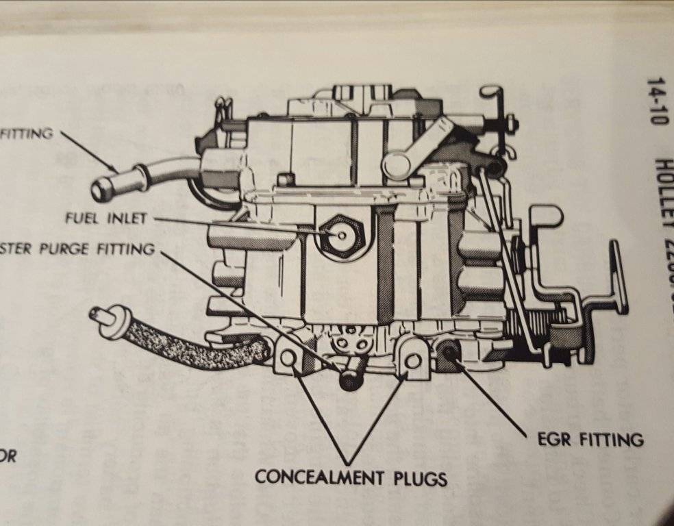

The carb I put on is originally off a '77 cordoba, so it doesn't have any plugs or solenoids. It also doesn't have those stupid concealment plugs for the mixture screws.

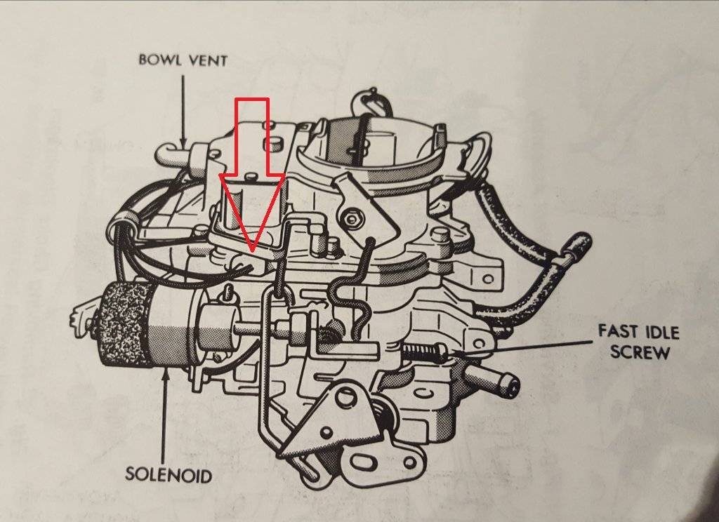

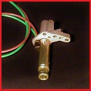

The 6280 actually has three solenoids.
The red arrow points to the third solenoid, which is the fuel mixture control solenoid, which is what the Lean Burn computer uses to adjust the fuel mixture while driving.

This is a US emissions thing. All other countries get the normal carburetor (unless special ordered with the US emissions package).
This solenoid has roughly a capacity to adjust the air fuel mixture about 10% (or so).
This is just another reason why gasoline with 10% (or 15%) ethanol mixed in, causes problems for our cars – because vehicles running ethanol requires 10% (roughly) more fuel compared to 100% gasoline – which is more than carburetor can compensate for – or is close to max limitations.
The Fast Idle solenoid is either used for A/C (bumps idle speed up a smudge) and/or is used for after-run condition (when vehicle is turned off but engine has a piston hot spot and car keeps running from hot spot igniting the fuel). By opening the throttle a bit, it generally will keep the after-run gremlins away.
I consider this to be a good solenoid.
The bowl vent solenoid does keep gasoline vapor of the atmosphere and does keep gasoline in carburetor (evaporates out, especially after hot engine shutdown), which makes startup easier and fuel mileage a bit better.
If system is working, I recommend keeping it in place.
If I’m missing parts, I doubt I would go the distance to find parts to reattach it (unless visiting California with the car).

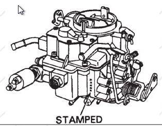

There is a number engraved or stamped on all carburetors, that identifies what brand, model number and usually a date code.
Generally, it takes some cleaner and some scrubbing to read it – once you know where to look.
View attachment 17152 View attachment 17153
