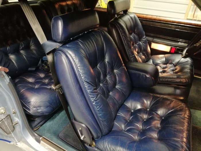

Was waiting to see how the upholstery turned out.
