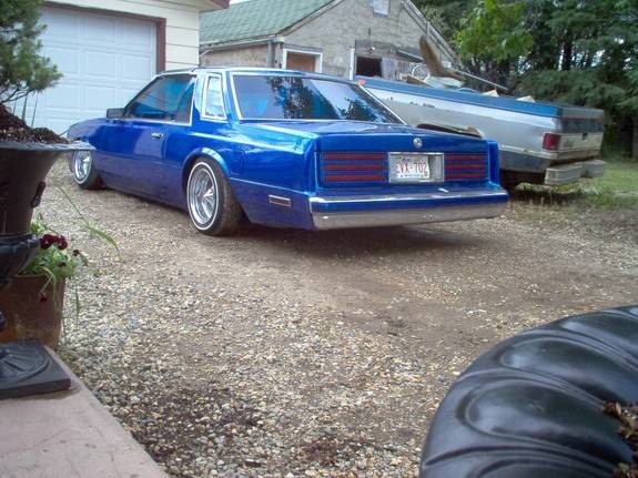

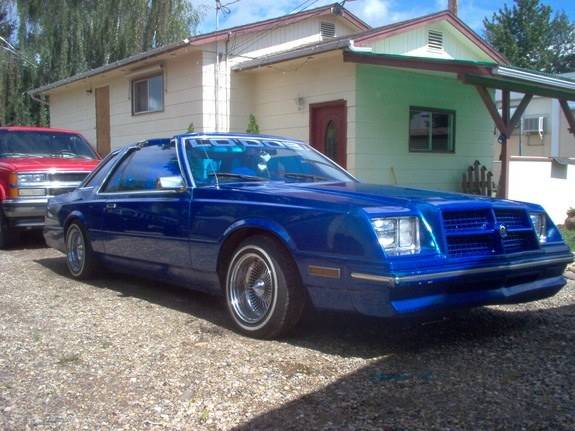

    I am pretty sure that car is riding on smaller wheels (14" or even 13"). Front end geometry looks wonky.

    I agree, that blue one is pretty out of whack. It's a bit low for my liking even hah.

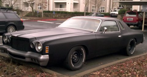

    Camber angle looks wonky on thyour car, too.
