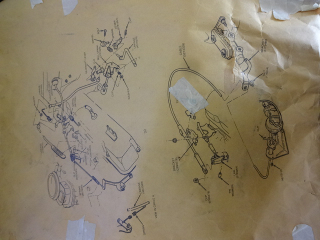

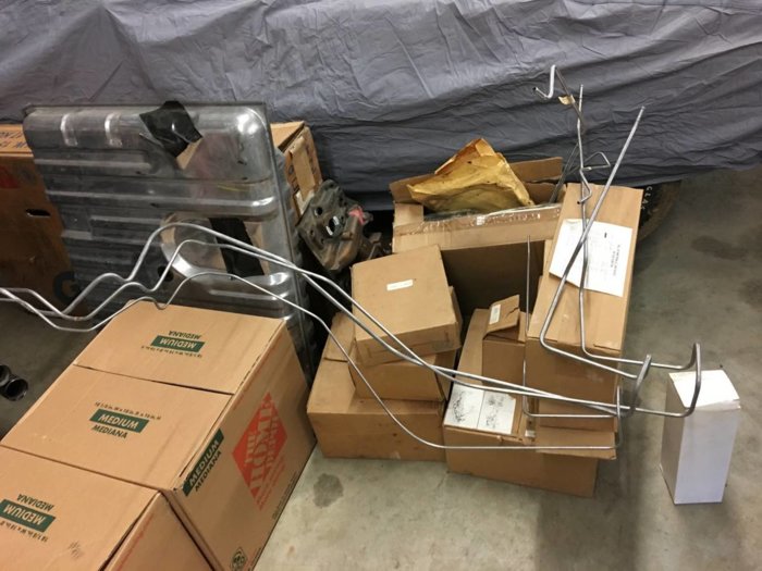

Which might tell me why I have this package of parts. I got these with lot of mopar parts and its also got a new throttle cable. Ive a bunch more from this envelope but you get the idea.
I wonder what carb and intake they replaced things with?
I do wonder what older wireharness might plug into your bulkhead?

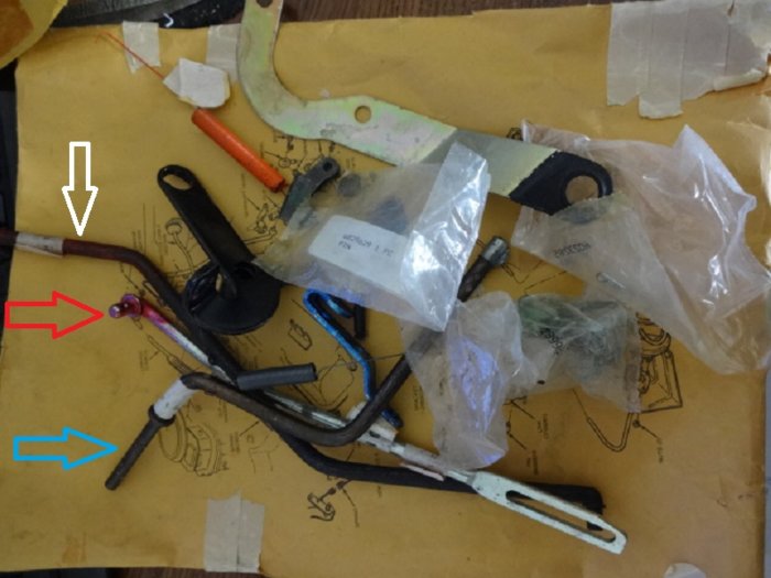

The Imperial FI change-over – reverted to a normal 318 2-bbl.
This rod (red arrow) confirmed it is for a “normal” 318 2-bbl, for the 4-bbl rod and FI "top" rod are bent differently.
The other two rods (white and blue arrows) are the other two kickdown rods (downward and transmission) – which I didn’t think was different (but not compared those two rods to a 318 2-bbl, before).
This picture (below) is all of all of the parts needed to change an Imperial FI over to 2-bbl).

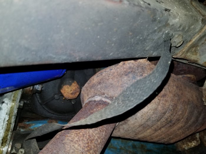

As a follow up;
I was pulling the front disc rotors so I can redo the bearings and found yet another ground strap!
If you can't see, it goes from the frame to one of the transmission bell bolts.
