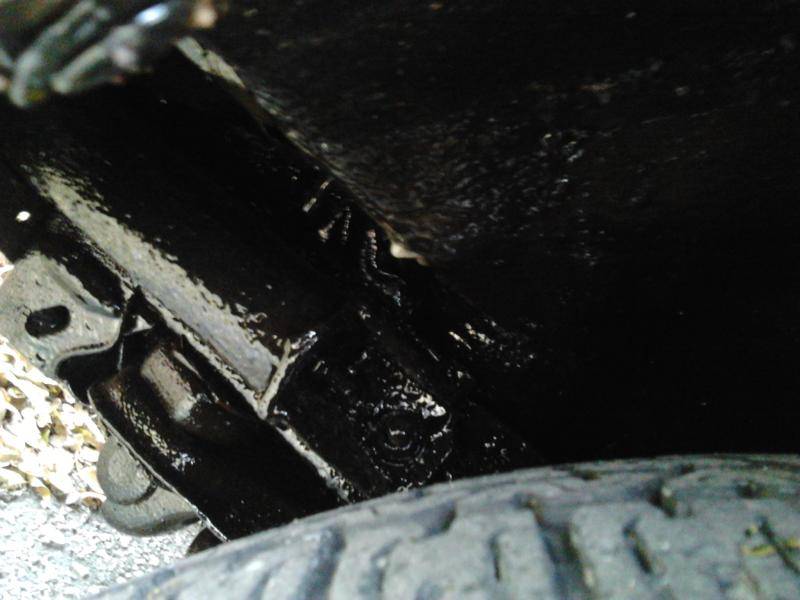

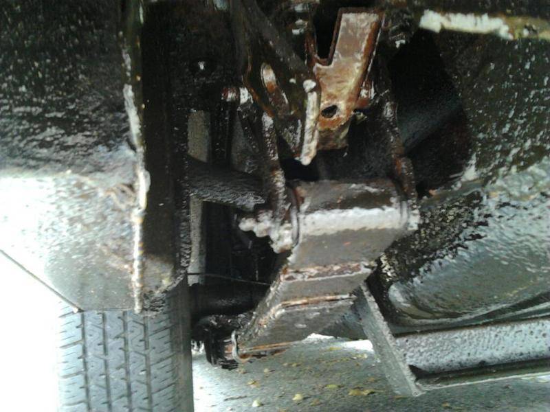

Just got mine done last weekend.

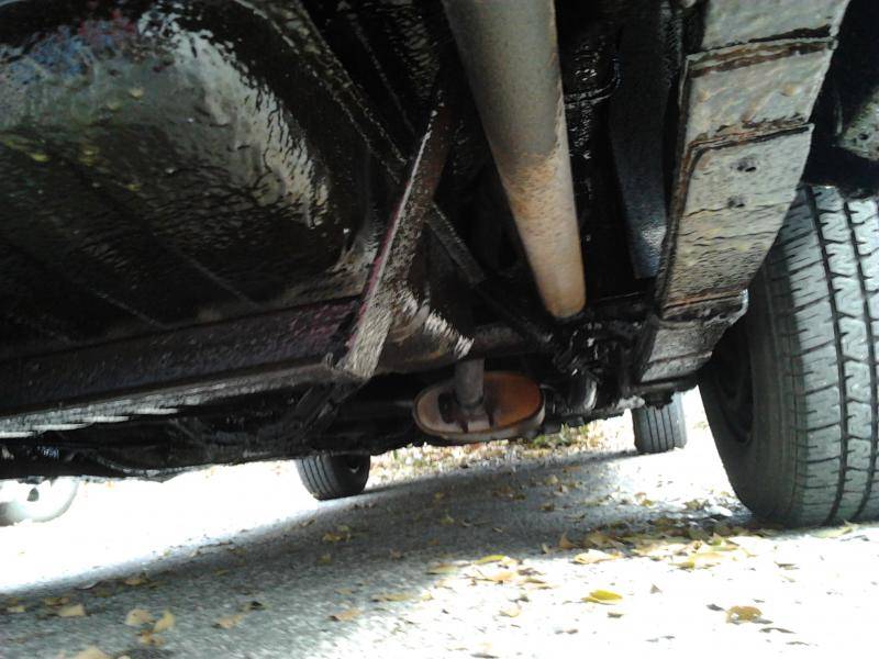

I know the guy's at this place.
I told them this was the last winter the 5th would have to endure so hose it down big time.
They did NOT disappoint

Yeah, they go nuts with salt up here in the winter.
Only hope you have is to nuke your car with this oil stuff.
Not real sure what it is but it's definitely oil based
Two different consistencies.
Runny stuff in the doors, rockers, creases and crevices.
It's supposed to creep.
Underneath the thick stuff (of course it's made with maple syrup)
Thick as hell and sticks like glue.
Did it last year and there was still some left when I went to get it done this year. Works too. No extra rust issues after driving it all last winter.

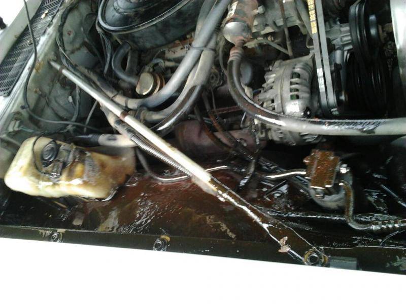

Hahaha even the engine bay?! My t-top Mirada was oiled up way back when it was new and its still a gooey mess underneath. Whatever they used its tuff stuff because its survived 30 years and 97,000 miles without looking a day old.
Yep, engine bay to boot.
I've seen salt in engine bays before so it is a good idea.
And yeah it does last a long time.
That's probably what saved the Mirada
Especially if it was a Canadian car.
No heavy oiling and they're done for.
Welcome to Canada.
Actually any snow belt area where they salt heavily..
It's a necessary evil.
Messy as hell when it's first done but it does flatten out by the spring
Besides, I'd rather have an oily car than a rusty one.
