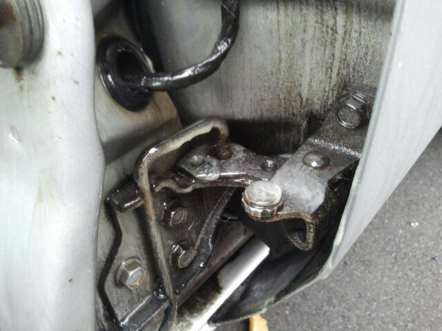

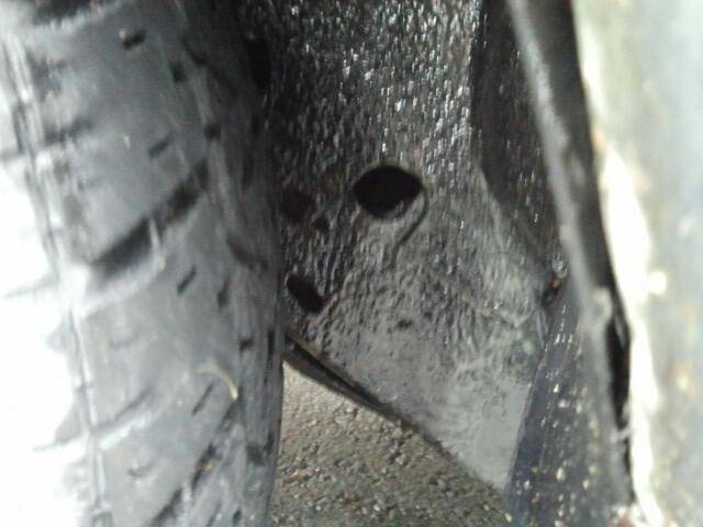

So once again the Fifth got drowned in oil.
And once again the boys at Reg's did not disappoint.

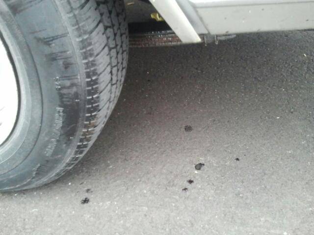

Already dripping.....

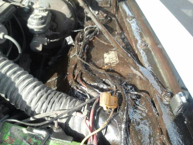

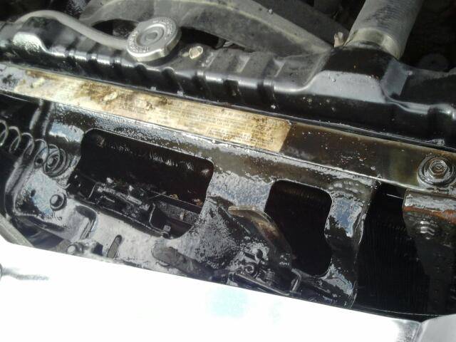

Mmmmmm......engine bay....

I could never do that to my car ,,,i know alot of people oil spray but ,ive never ,and had no issues ,,just need to take the car to the was 1 time a week and get er sprayed with water and clean it up ,, i think i got a cleanlieness phobia
Actually by taking it to the car wash you're making things worse.
It may look all cleaned up but what you're really doing is pushing the salt further into every crevice with the pressure of the spray.
Everytime you drive in the salt slush the slop is being impacted into the hidden valley's of your car.
If you live in a place where they salt the roads you have two choices.
Don't drive your car in it or get it drowned in oil.
There's no in between.
The Fifth is my daily so I drown it.
The Caravelle and the Volare go away to the cozy dry garage till the spring.
And they don't come out till there's been two solid days of rain to wash the salt away....

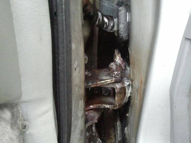

Man the engine bay pic is nasty ,oil all over the wire??? Are you looking to burn up your car? Thats a crazy fire hazard ,,i wouldn't even feel safe in it capt u sure thats a good idea??? Ohhhh yack sorry man but thats nasty looking ,ive never seen worse,,the door hinges i agree with but thats it ,

As far as the electrical goes.....it's oil....not water.
Never had a problem.

Think of your leaf springs....see the crevices in between them.
What are the odds of the car wash getting impacted salt out of there?
Pretty slim......there's crevices like that all over your car.
The oil creeps and provides a barrier. It works.
I can attest to that to that by the lack of damage on old iron that I've salt soaked. Me? I drive the Fifth cause I have to. So I drown it.
