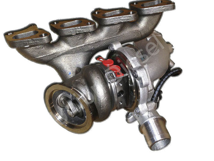

Getting to another subject, a Turbocharger for a Chevy Sonic, GM part number 55565353 looks like:

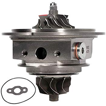

This is the only way to get a turbo (which is about 1/3rd of the engine). Many times, all a person needs is a turbocharger cartridge replaced – which you can’t get from GM:
Sigh. At least we are keeping Aspen500 busy.

I forgot about those. I've personally replaced half a dozen of those so far, and a couple others were done at the shop as well in various GM Eco-Tec vehicles. Every one of them had the same problem. They come in with the MIL on and complaint of lack of power. Housing cracks at the waste gate ports and then you have a boost leak. Like having the waste gate partially open all the time. Don't recall the price for parts and labor but, it's not cheap and it sure as heck isn't a quick and easy job to do either. They've all been on cars 2 to 3 years old but with too many miles for powertrain warranty which is why we were doing the job. It's gotta suck having 2 or 3 more years of payments on a car and then having to stick mega bucks into it. Eventually a lot of the cheap parts that fail WAY prematurely is going to backfire on GM when people trade their GM product in for another brand.
