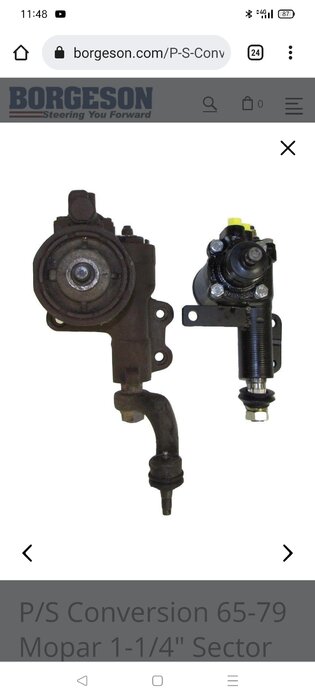

Borgeson are illegal in NZ due to the Steel brackets bird shit welded to the body of the steering gear. Check out photos and see if you would put your life on the line.

Check out the photo on right, check welding
Camtron
Apr 25, 2019
2,274
1,853
US
Oh wow. Welds on the left hand models too. Interesting.
Seems plenty of people use them just fine here.
Now those imports were the whole housing has been welded, I can understand those being banned.
Take your chances I guess but here they are banned!
If you read the NZ LVV bulletin they became aware of this issue after they suspect a weld broke, I dunno what you guys know about welding, I tried once to weld cast iron to steel, heating up, cooling down etc with I think was at the time low Hydrogen rods, (going back 20+ years now) and the welds cracked, so I know some places can weld blocks but everything has to be perfect and if it cracks later in life I doubt a crack in a block would have any impact on you like a steering wheel that turns and does nothing at 80mph :)

For what it's worth Borgeson has a second generation version of that box without the welds. The housing is all cast one piece.
Borgeson Small Sector Steering Box Only - Bergman Auto Craft
This is the version I have on my car and my Dad's car. You're not going to get any better than this. This box does remove the slop at 12 o' clock. Pair it with one of their power steering pumps. There are so many different flow and pressure combinations on Chrysler power steering pumps it's best just to get one that is matched for the box.
There are no rack and pinion conversions that I know off unless you're replacing everything with a custom K frame. The steering on these cars is behind the wheels and all the rack/pinion setups I see are forward of the wheels.

1,492
He (or We) need the Large Sector shaft box for FMJ's. The pictures do appear to be all cast (ie: no welds).
Thats good to know as the welded ones were not allowed here! My car has the power steering pump that came with the magnum in the day, were those pumps all different pressures too?
