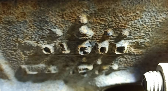

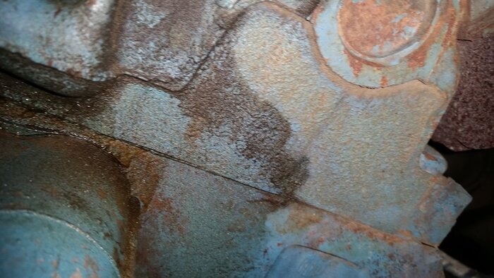

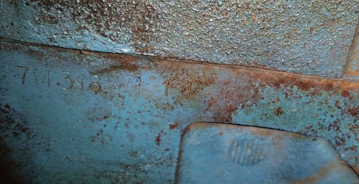

Bruce, what year Magnum engine did you get?
I can find out those pressures for you.

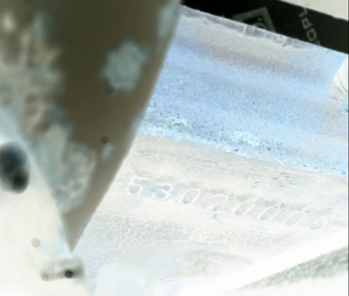

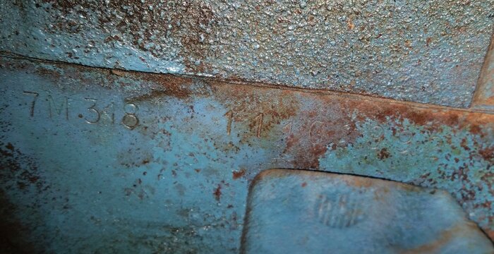

I have taking a photo and revesred the colors to make it easier to see, is it 2000? 5 30 2000 6 or is this the wrong number, got off passenger side block, I think this is more a part number, hard to see with headers and engine in car :(

The number stamped on Left front side of block, under the cylinder head would be a bit more useful, like this number:
But - I think I have enough data to help with pressures.

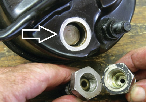

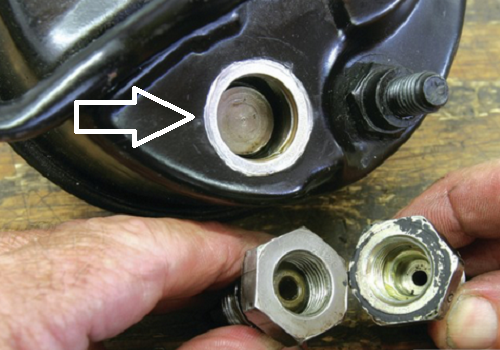

The pressure regulator looks like (white arrow, above):

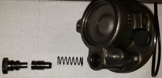

This picture shows the can off, but regulator can be accessed with with pump on car and fitting removed (top picture).
Note: you will experience fluid loss when you remove the hose and/or fitting - so have a catch can (or something) ready).
Note: use of a small magnet might be needed to pull the regulator out of the body. Sometimes pushing it in will allow it to pop out (via internal spring pushing back).

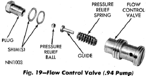

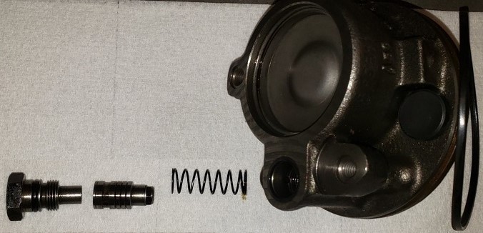

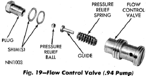

The regulator taken apart. Here you can see the shims used and/or pressure release spring used to alter your P/S pump pressure. There are two springs, The big one on middle picture (which sometimes will push the regulator out when fitting is removed) and the smaller spring inside of the regulator (last picture).
There is plenty of websites talking about increasing or decreasing the P/S pressure on the Saginaw pump - so a person can adjust the pump pressure to something of your liking. Both of my cars, the pressure setting is too high. I can drive with one finger, if I wanted to. I like to have a bit less pressure so I can feel the road better. The pump on my '97 Dodge pickup is the same way - too much pressure - but it also powers the hydrobooster (power brakes) - so hesitant to play with it. That said, this is on my long "to do" list.

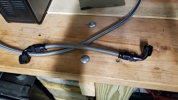

So what do I need to put it in, coupler and steering gear?? Any idea how much they weigh? USPS do a flat rate 20lbs box to NZ for $120USD but since coivd USPS have stopped shipping to NZ :(
The box and steering shaft coupler at a minimum. If you look at Bergman Autocraft they have a coupler that you can use that doesn't involve modifying the steering shaft. The rest can be done yourself if you want, or Bergman also sells all the fittings and hoses you need. I opted to plumb it myself using PTFE braided lines. The box itself the ports are 16mm inverted flare. Used some adapters to go from that to -6AN. Used another adapter to convert the pump port also to -6AN.
If you want to make your own pressure hose it has to be PTFE and the associated adapters. Regular braided hose won't stand up to the pressure involved.

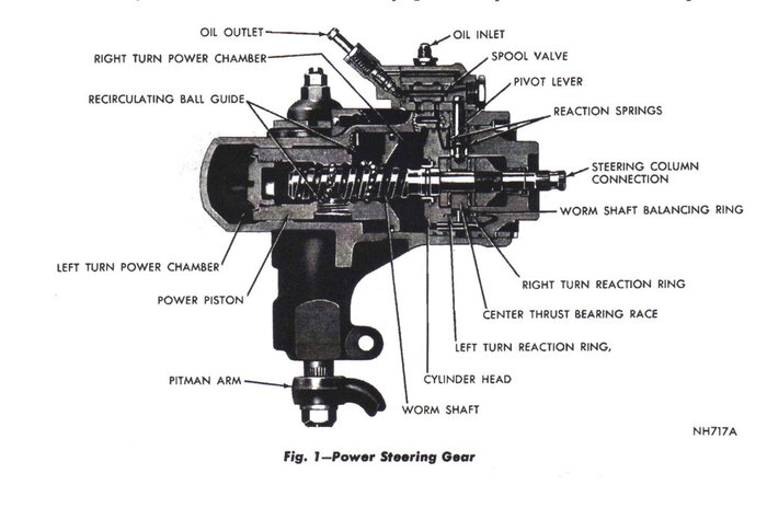

ok lets take a look at this diagram, the oil comes in and is directed to the left or right hand chambers, so you turn the wheel to the left and pushes the steering column back a little bit some how controlling that pivot lever thing to direct the oil to the left chamber to assist, and this is the reason why you have free play, the gear needs free play to work the oil control?

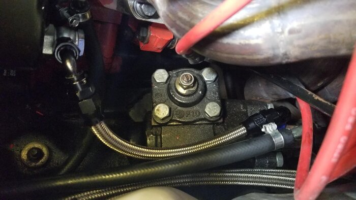

Borgeson are illegal in NZ due to the Steel brackets bird shit welded to the body of the steering gear. Check out photos and see if you would put your life on the line.
Old picture there, all current boxes are a one piece welded casting. You can see it in the standalone picture on our website here: P/S Conversion 62-72 Mopar 1-1/8" Sector Shaft I know NZ can be strict, FWIW we have never had a weld failure on any of our welded boxes, we switched to a casting to alleviate some welding time as it was taking around 45min to weld a box.
