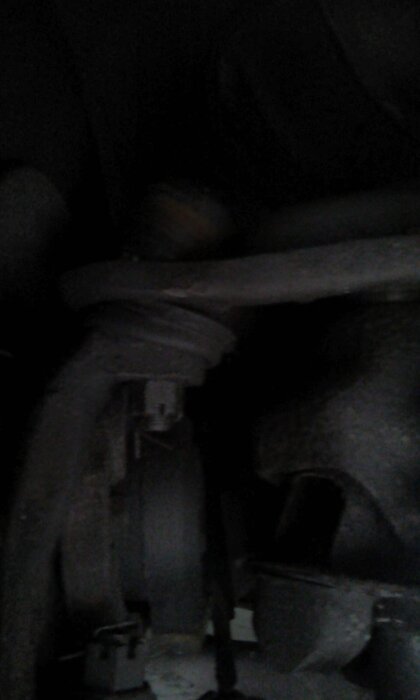

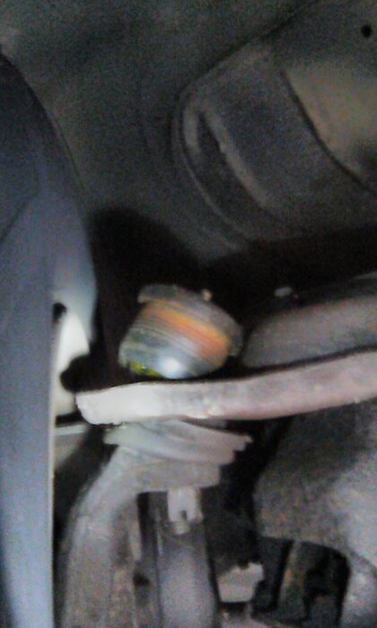

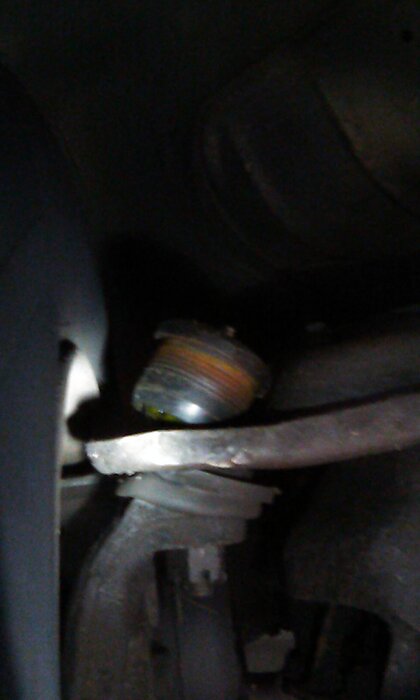

I heard a snap when pulling into the driveway I looked underneath and here's what I found

Kinda hard to tell by the picture.
The upper ball joints are threaded into the upper control arm. It is possible for those threads to rust away/strip pretty easily on a 30+ year old car and that could cause what you’re seeing.
That ball joint also looks kinda rust and old looking at the picture (but it’s hard to tell), you sure they got replaced?
That sucks either way, man. Sorry to hear.

I had that happen a long time ago. As a temporary fix, the ball joint can be popped back in the control arm and then welded. It'll probably wreck the dust boot (if it isn't already) but it'll get you by for a while. I ended up driving my car 5 or 6 years like that, although I did replace the dust boot. What happens is, the "threads" in the control arm get worn so the joint won't stay in properly. IIRC, the minimum torque needed to get the ball joint screwed in all the way is 125 ft lbs. That's not a tightening torque but the torque it takes to screw it in BEFORE it's fully seated. They are a heck of a thing to remove and replace, using the correct socket and a looooooooooooong breaker bar.
If you jack the front end up, the ball joint should be able to be put back in. Since it came out, screwing it in is a moot point now. Find someone willing to put a few tack welds on it. It actually doesn't take all that much to keep the joint in since there's basically no weight on it. The control are and joint will need replaced at some point so don't be worried about ruining good parts. Good luck,,,,,,,,,on everything.

The arms aren't available new (far as I'm aware), unless you go with an aftermarket tubular control arm ($$$). Check with Deconstructor Jim for a replacement. Chances are the rust free ones he has have original ball joints so the threads and hole diameter are more than likely good. Yes, the shaft bushings are readily available from any number of sources, including local parts stores.
Jim's Az Parts
The ball joint that gets welded in will be fine, you just have to remember to grease it more often if the dust boot is destroyed, which it probably is after the joint popped out.
Make sure the welder doesn't put too much heat into the joint. Tack it, allow it to cool, tack, let cool, etc. That way the nylon inside the joint (if it has a nylon liner that is) won't get melted.

You may want to get in touch with F body Deconstructor Jim. He may have the control arm/arms you are looking for. he is a board member.
It looks to me, from your picture, that whoever installed the ball joint didn't thread it in all the way. Note how the threads are Rusty on the top, indicating that they were exposed.
