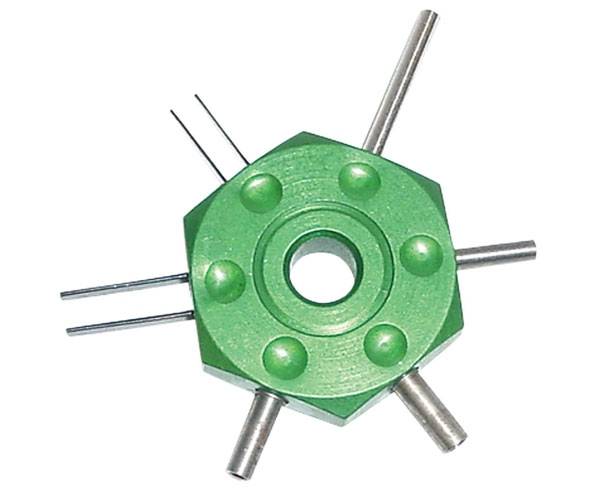

The connector tool looks something like this:
It takes a thin piece of metal to get in there (much smaller and thinner than a small screwdriver). This tool is about the only thing I know of to get those connectors un-popped.

A Tech at the local HD shop was answering some questions for me about the wire harnesses plugs and pins I picked up in 03 a stripped repo 03 1200c sportster at auction for peanuts. Tech said I could just splice and heat shrink the hacked harness together. I showed him the bags of plugs and pins, Im not a splice kinda guy. I want the wiring right so a manual and the harnesses can be properly traced. I dont like cobbled $#!t. Do it right. Me or the next guy might run into trouble on the road, never know. Then he opened his box and handed me one of them plug tools. I said Im gonna need it for about a week if thats ok. He said to keep it. Its used up and the tool I needed was well worn and not always worked anymore. He wanted to get a new one. Without the old one in his box, he would have to buy a new one! I returned with a 12 pack and was on my way. What Im trying to say is Thanks Bud! Im familiar with that tool and have a story to go with it. lmao Windbag salesmen-
