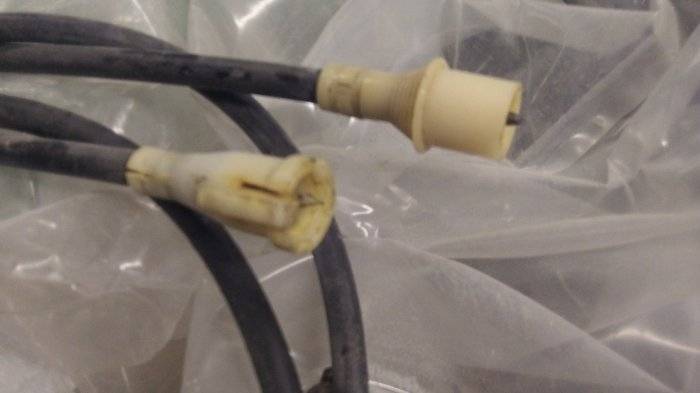

76 77 volare aspen use a special cable end at the speedo head. it is different from the clip on type.
1,492
1,492
Picture is from F_body_Deconstructor_Jim.
Of the '80's I've worked on, yours should be the Left Lower version (the by far, more common version).
Remove the knee booster (trim under steering column) and either craw under dash and look up with flashlight or bet a mirror and flashlight and you should be able to tell which one you have.
The Left Lower version will work in all cases (as long as spring clip is removed, via small screw). The Right Upper version will work if you have the spring clip in place (or some method of it staying it in place.
Some pickups and vans (and a few other car lines) had the spring clip version on and off through the years – as if Chrysler keep getting competing bids from cable suppliers (I guess, but not sure).
My opinion – six one way, ½ dozen the other way.
One is not better than the other – but the Left Lower version is more common and works either way (with a removal of small screw and spring clip).
