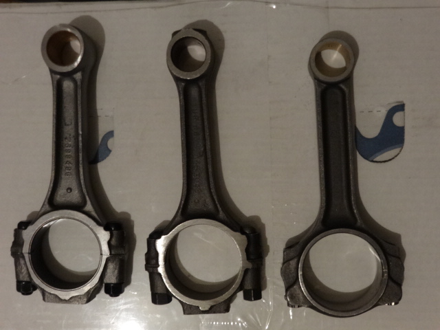

Scats on the far right, can be 200 grams lighter in trw vs a oem 340 rod.
You can tell in the second pic which build got the scat rods.

You reply is a bit confusing. The rod on the right is the scat lightweight approx 560g trw. 400g big, 160g small.

All small block rods are the same 6.123 length. What the heck thats small block 101. 318-340 3.31 stroke 360 3.58 stroke.
But never has a different length rod been in the mix in an la or magnum or even poly,
The ones I posted are left 340 rod, center 318 rod.
