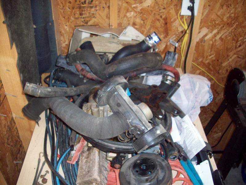

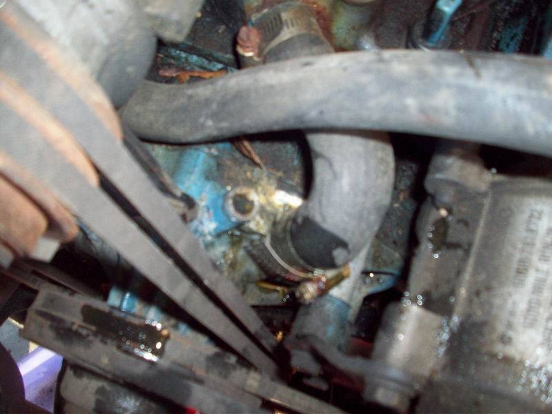

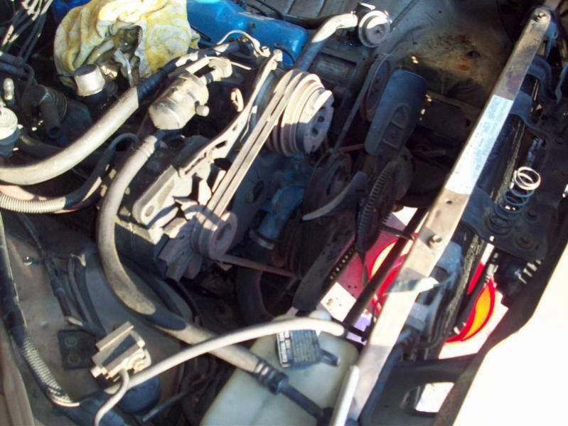

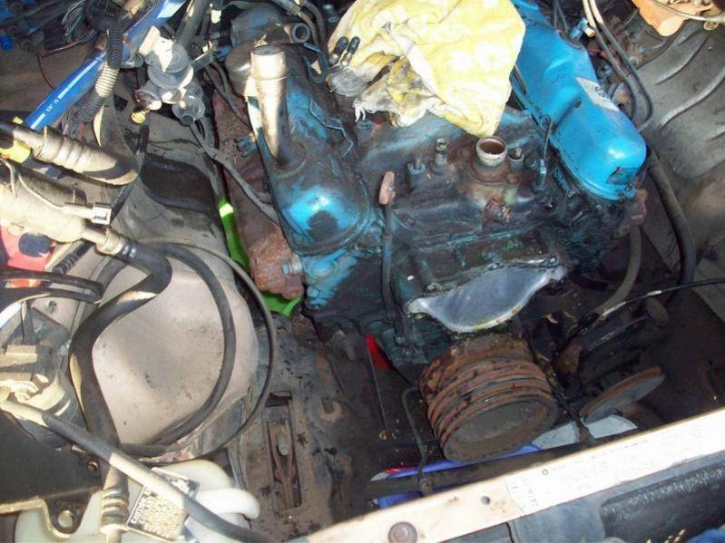

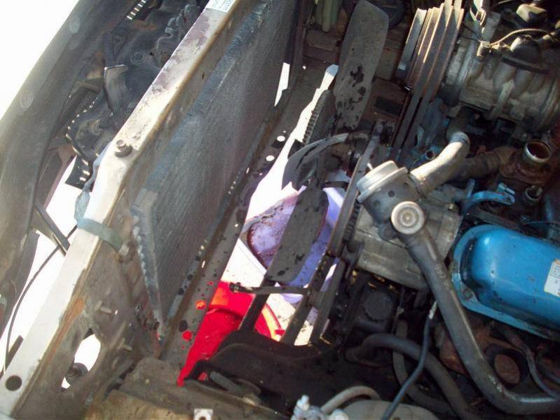

I worked a little more on the Imperial today in my quest to swap out the non-functional EFi to a 4 bbl/Elec Ignition. I pulled this and that and found a bunch of crystalized anti-freeze in the pump, so out came the radiator and I bought a new pump.
The PO never washed the engine. Never did anything to it. The belts and hoses are original Mopar (and need to be replaced). I have a lot of cleaning to do before I feel comfortable pulling the intake.

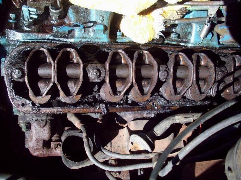

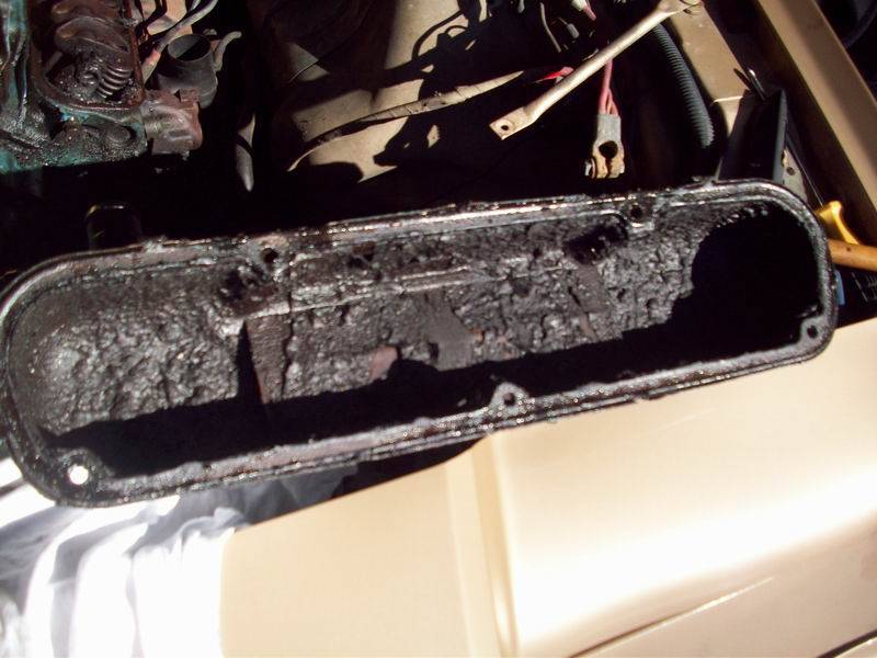

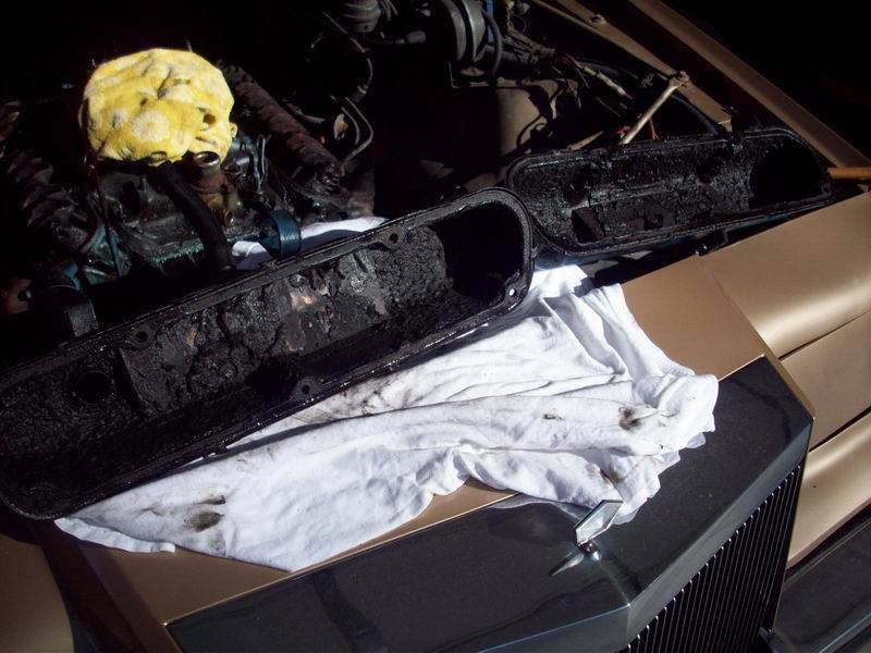

Well... that's it. I'm not spending another dime on cleaning the 318. The heads are full of baked on, burned on crust..... :puke:
I doubt the PO changed the oil in the whole time he owned it. :BangHead:
RB swap here I come... It will be much more cost effective... AND FUN.

Yea, I'd be $1500 into rebuilding this thing - There are a couple running 440/727s on Craigslist near here for around $500.
Get a load of how dry those rocker arms are... sheesh...
I just might throw a bottle or two of Seafoam and filters at it as you suggest and see if it gernades itself or not. LOL.... One dollar at a time...

if it was mine id pb blast the springs and arms and evreything just to break it up a lil and the engine foam if ur gonna change the oil then do this an change it again try using mobil 1 super not synthetic its a detergent oil works great with the seafoam that stuff works u could even use a whole bottle in the oil and half in the vacume and half in the fuel u get it from all directions .
and make sure to deeply clean the covers lol

Go ahead and pull the intake, see how bad the sludge is in the lifter valley. If its not bad, just remove the heads and give them a good cleaning.
If you start to put cleaning additives in the oil to help remove the sludge build-up, you know were it going. The end results will be a plugged oil pick-up and burned-up lower end.
If I were you ( but im not), take the heads to a local engine builder and have them hot tanked, to clean them up. Install new rocker shafts and arms. Put her back together and run her.
My 318 in my roadrunner had some sludge build-up in the heads. So cleaned it up and started using Brad Penn Racing Oil 10W40. Its a high zinc formula oil, synthetic/ petrolium blend. Very high detergent, to keep thinks clean.

Me and a couple buddies have thrown ATF and Seafoam in motors before to clean them out. Let the engine get up to temp, then Seafoam it- if it chunks the motor (from blocking the pick up w/debris or something), oh well, they were "Yard Removals," but we haven't yet...definitely turns the ATF nasty, but the gunk starts flying out of it.
PS-that looks like every motor I've ever seen that ran Pennzoil. Chunky , smelly and crappy
