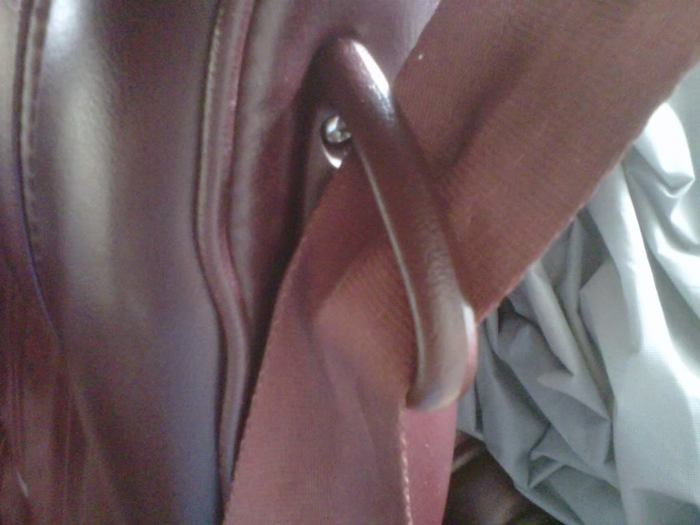

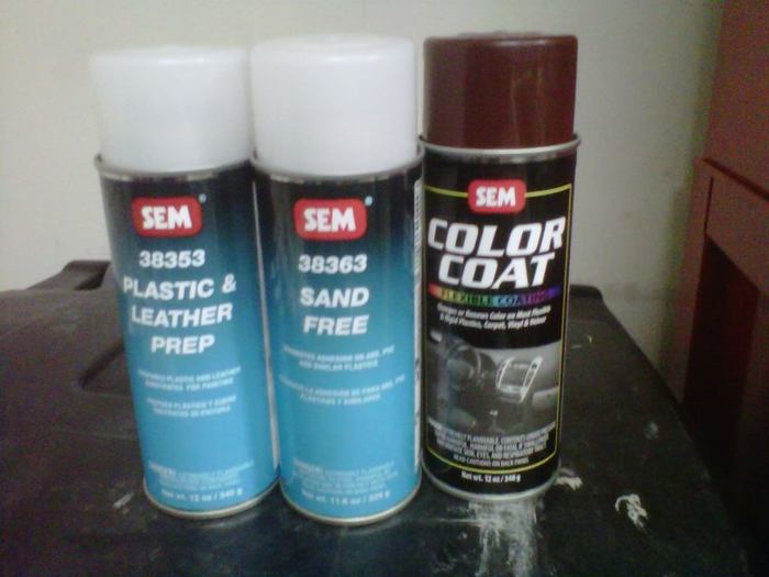

Got my three cans from Eastwood
Three days thanks to FED Ex and they were here this morning on the front porch..I couldn't have picked a closer match...

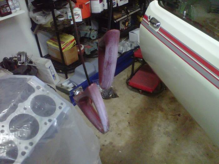

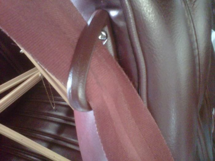

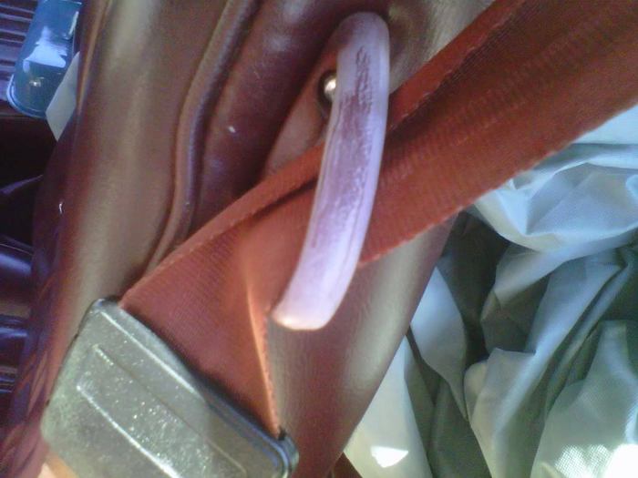

I found out on the first one it very easy to slide the seatbelt out of the loop by leaving the top screw in and carefully prying a gap open at the bottom while sliding the seatbelt out...this is how faded they are..the very worst looking thing inside the car..

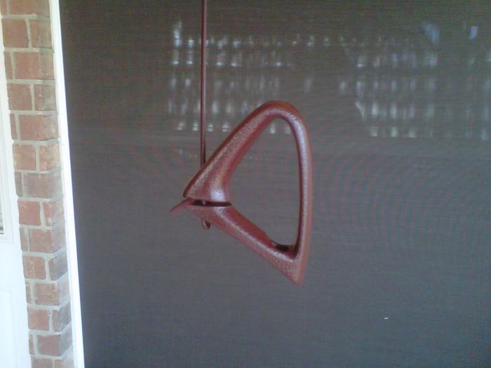

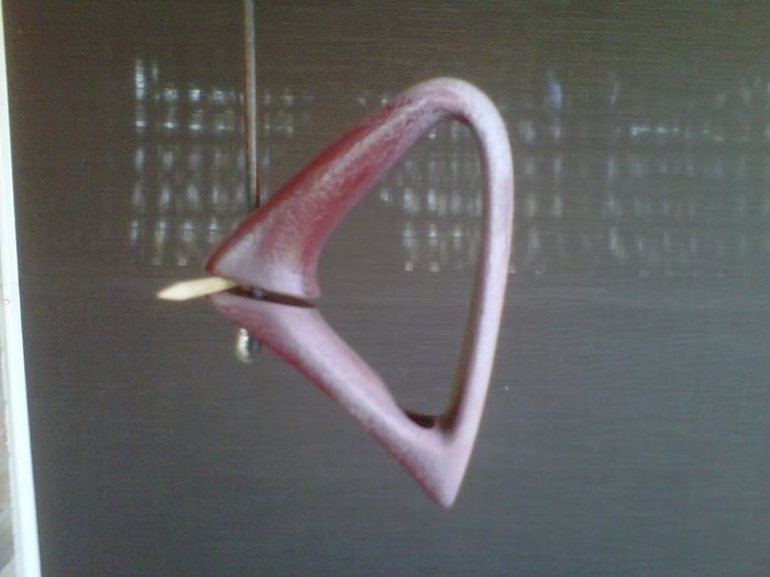

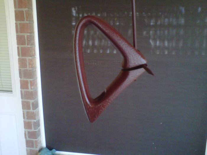

Done
Before: I scrubbed with soapy water...and inserted toothpick to keep the halfs from sticking together...sprayed and wiped off the prep and let them dry...
After: I sprayed it with the sand free then three light coats of color 5 minutes apart...the temp was 73 degrees so they dried fast....
Looks new to me..I also like how it leaved the grain detail alone..I will take two more pics later on when I put them back on the seats..

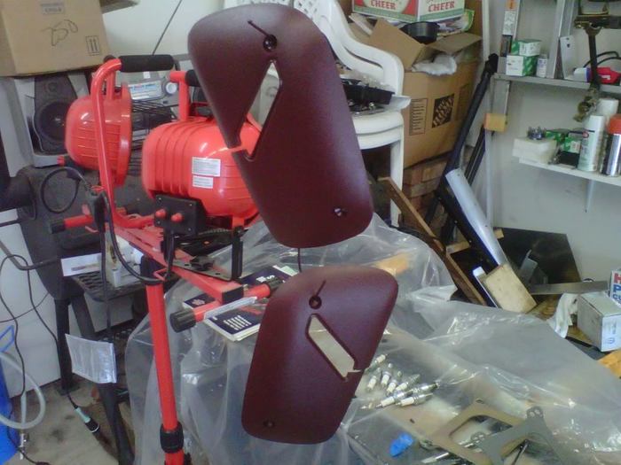

I also did these seat belt cover plates..they really weren't that bad they just had a couple of scratches...but once again they turned out wonderfull...

Wow! those turned out great. Eastwood products are top notch in my book. toolman

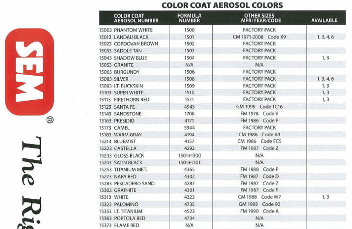

Interior Paint
That paint looks great. Over the winter my son and I have been doing a resto-mod on his 80 volare RR clone and yes the interior plastic is badly faded so I went to the local auto paint supply and found a product that is just like you have there called Sem it comes in rattle cans or you can buy it mixed to any colour you want reduce and spray works very well. I have lots of pics of the project but I am waiting for my son to resize them as they won't load on this site but they will over on FABO so when he does this I will do a resto thread.

Yep I found it on-line and yes you can get it at some good local paint stores..I have yet to see it in any of the box stores such as Napa, Advanced Auto parts etc...

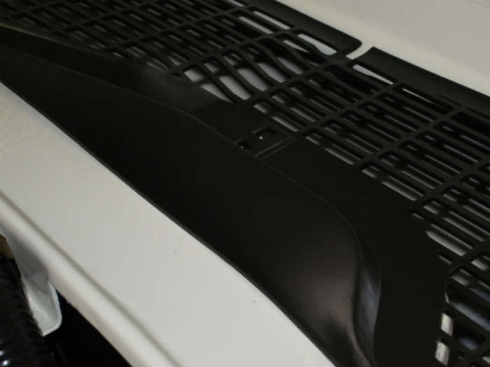

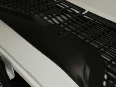

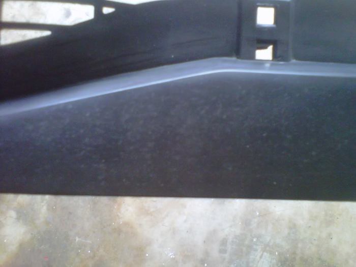

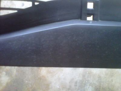

I cleaned up my cowl screen. It had a faded spot on the very front so I wanted to give that SEM color coat another try. I found the 15243 Satin black at my PPG paint store. I cleaned it with hot soapy water first then used their prep spray and sand free spray. Then three coats of the satin black.
I took this picture with my camera at night...there are two lighted up areas that are not representing the results. Look at the overall satin black color.
