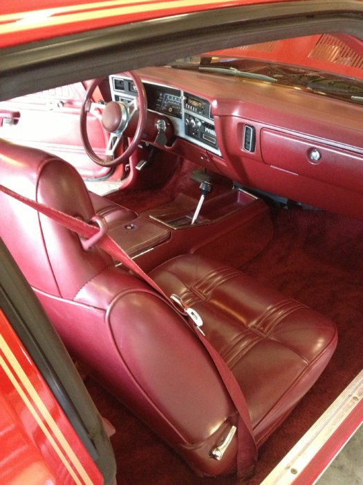

what color red was used for your interior? I'm too color blind to tell them apart. Napa, Firethorn and Portola red all look the same to me.
