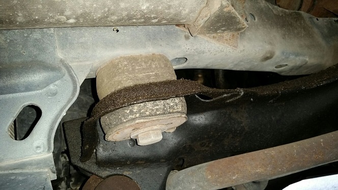

Your front K-frame mounts in four points to frame (picture is L/F corner looking towards the R/F wheel).
Most users, the original rubber mounts are fine. Many enthusiasts prefer solid (or harder rubber) because they handle better. Think of it this way, on a hard turn, these four bushings “give” before car begins to turn. Yes, they do reduce NVR but at the expense of other functions.
I have a set from Firm Feel, but need two more sets.
Note: I will wait until doing two or more major things on car, before changing them.
