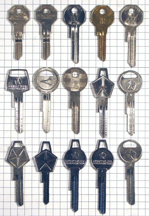

Some further clarification.....
http://www.key-men.com/cars/Chrysler.html
These are examples of original Chrysler, Dodge, Plymouth and DeSoto key blanks that we stock. Chrysler tended to use the same basic keys from the 1930s up through the late 1950s, just varying details of the appearance. Up into the 1950's the "DPCD" type keys were used. Before WWII the keys were shorter and had a double shoulder design. After the war, the keys were a bit longer, and there was only one shoulder. During the late 1950's and into the early 1960's many different designs were used on the heads for the different cars, and then in the early 1960's Chrysler started using the same keys for all cars, all with the Chrysler pentastar logo on them.
Some keys were made of aluminum and as a result are very scarce now, but except for those, we have a good stock of NOS Chrysler product keys going back into the '30s and earlier, including the Yale Omega keys used during the early 1930s.

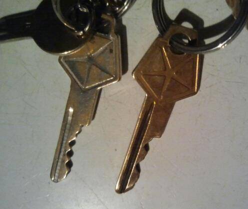

And even more....sorry I like to be thorough.....
In the first pic you see me Caravelle and Volare keys side by side.
Identical....
Then you see the Volare and 1987 Fifth keys side by side.
You can see the groove is longer and wider on the Fifth key.
Something to keep in kind.
My suggestion is to simply physically compare the groove lengths and widths on your keys compared with the blanks....if they're the same I'd say you're golden.....

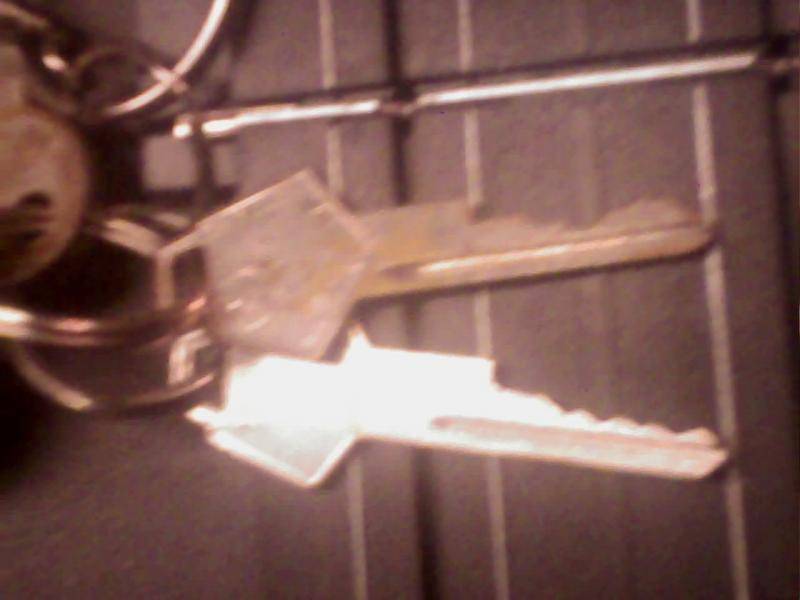

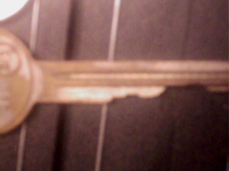

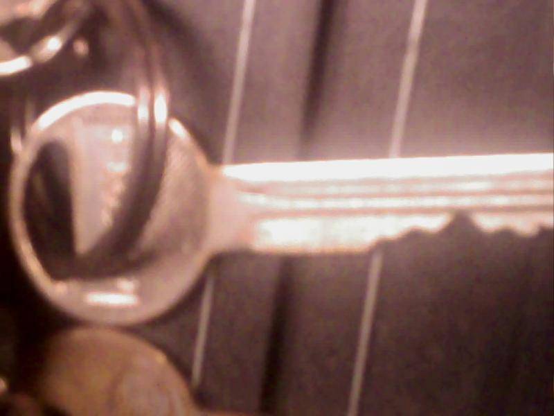

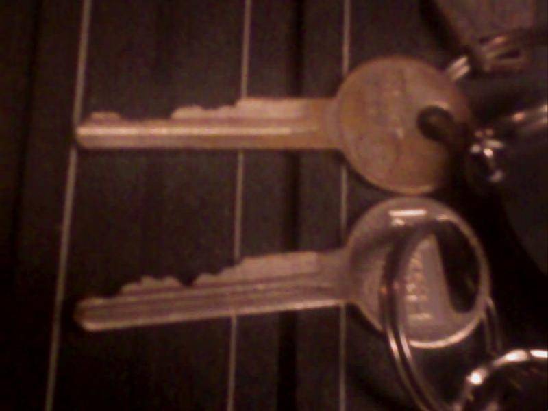

More comparison. 79 volare keys compare to roadrunninmark's 71 cuda keys.
The cuda column key (one with the pentastar) has the side grooves further back towards the pentastar. The trunk keys are the same minus the top notches
