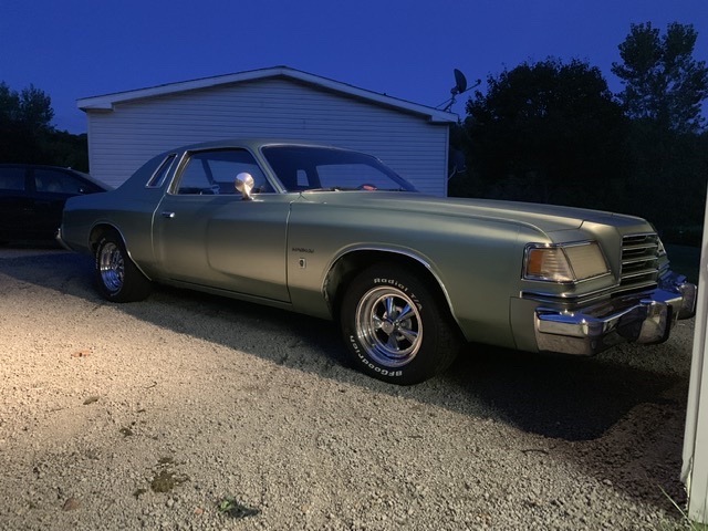

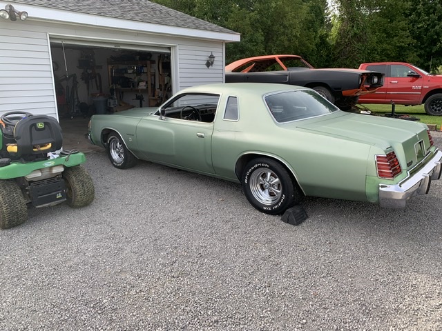

Hey
Thanks for all the great information, Was thinking about selling it then rebuilt the transmission and see how clean the car is underneath I’ve decided to keep it and drive it but the lean burn is giving me issues with bogging down when you step on the pedal. So I figured a small upgrade should help the performance a little and have some fun

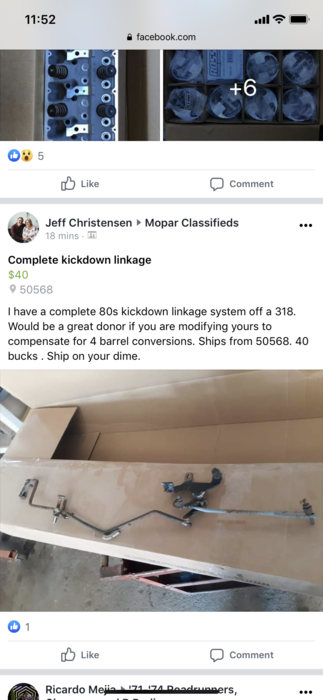

Just saw this on Facebook if you are on it. Even if you are not a member of that group just search for the user and contact him that way.
The B-body can use the more popular 1-piece kickdown linkage (the one that has a three-foot long rod) as well as the hard to find A/FMJ-body 3-piece kickdown linkage setup. Going cable is also a valid route to take. The Magnum has a lot more options than we do, here in FMJ land.

The facebook link set is more complete then the other one and also cheaper. Going with an aftermarket cable setup is probably the best route if you don't know what carb you want to use because the width and location of the throttle linkage on different models of carbs can vary a bit so a factory setup might not match what you end up using.
