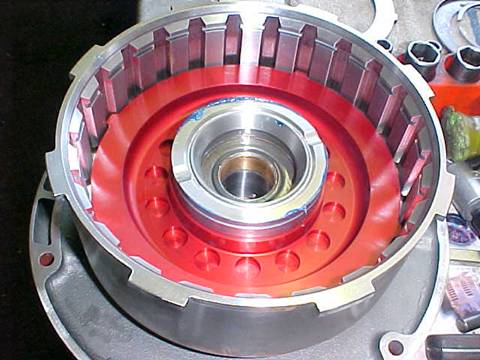

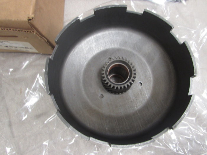

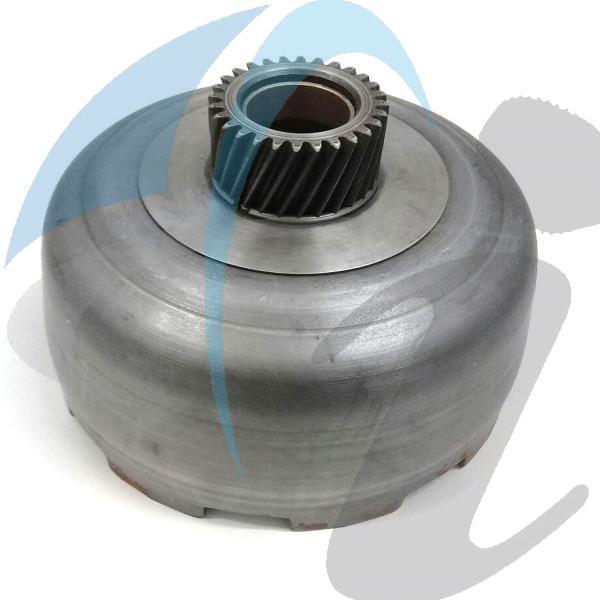

On most (automatic) Mopar vehicles, there is almost always a clunk that sounds like coming from center of car, when vehicle is shifted from drive to reverse. The main reason for this is the way the transmission sun gear shell looks (acts like an amplifier of metallic clunk noise).
Also, with the several parts inside of transmission, propeller shaft and differential, there is several items that has a little slack in them. A lot of “little slacks” equals to a lot of slack. What ends up happening is the front clutch drum where it splines into the big end of the sun gear shell – with all that accumulated slack the aluminum planetary gear slams into the shell – accentuated by fact these parts are changing rotation direction – the slamming parts rings that shell and sounds like a clunk.
In most cases, the clunk is not anything to worry about.
inner and outer picture of sun gear shell
Front clutch drum (and rear side of front pump).
As splined together
