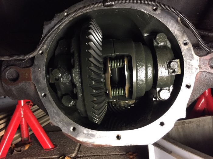

I actually had the cover off in February when I changed the fluid. Took a picture of it to determine whether it had LS diff or not (so I would get the right oil).
Don´t know if it´s the 7 1/4, but Im sure you guys can tell from the picture.
I dont think the car has been driven hard at any point in its life. A 2-bbl carb and a lean-burn system will keep that in check .. Many people here in Denmark soup up their engines just to be able to do longer burnouts - not me though.
