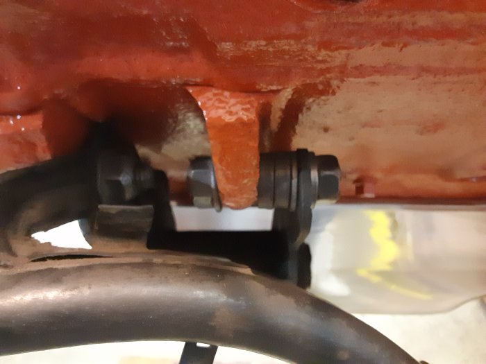

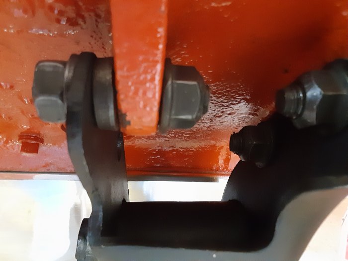

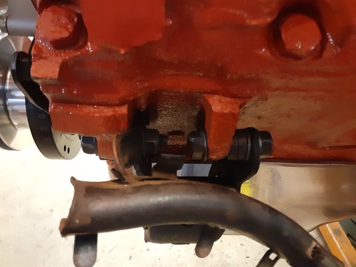

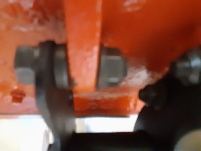

Just tried these non-oe mounts and tried shimming them as described in the text. Is this correct where I landed ?

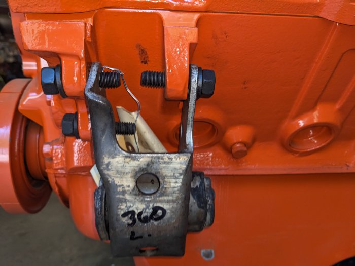

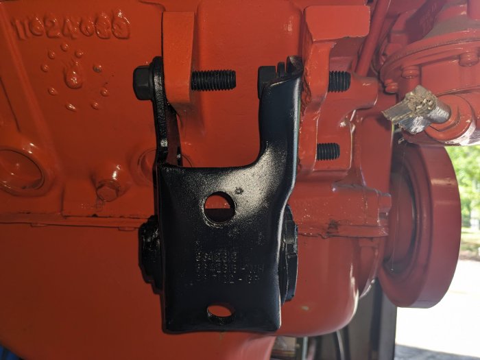

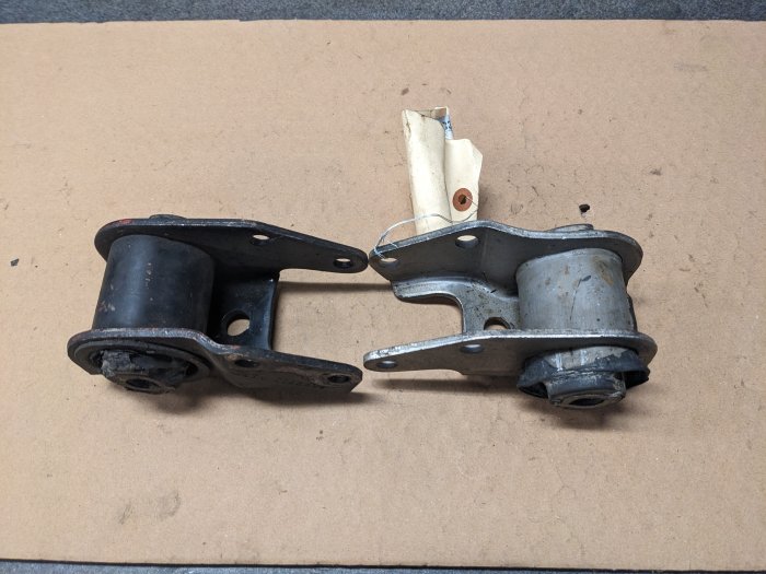

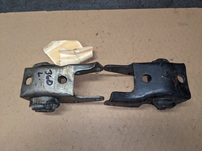

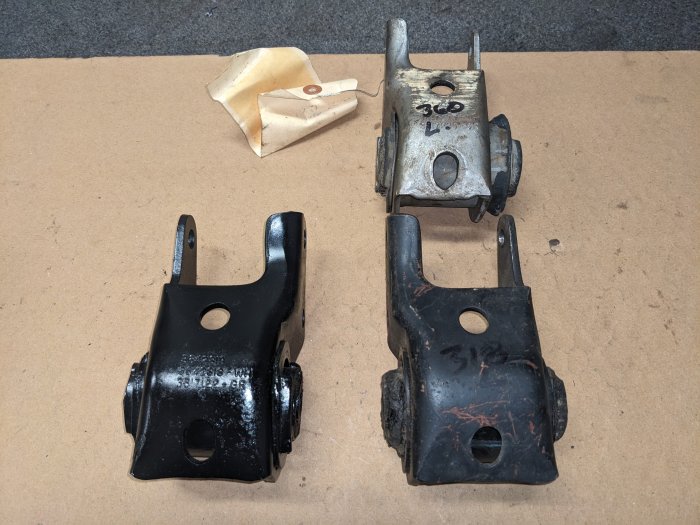

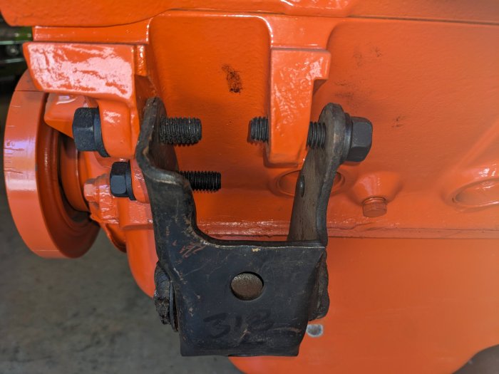

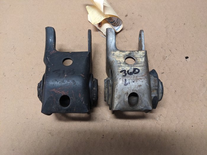

The LA small block engines use the same engine mount mounting on the right side, whether the spool type, or the earlier separate bracket and insulator type. The 273 and 318 use the same engine mount mounting on the left and the 340 and 360 use a different spacing on one bolt for the engine mount mounting on the left, whether the spool type, or the earlier separate bracket and insulator type. The 273 never used the spool type in a factory configuration, but it can mount like the 318.
Original Chrysler spool type mounts are shown in the following image:
An original Chrysler 318 left mount is shown in the following images with an NOS Chrysler left 340/360 mount side by side for comparison:
The 340/360 left mount is shown in the following image on a 340 engine:
The 318 left mount is shown in the following image on a 340 engine. Note the gap at the rear mounting face to the block boss:

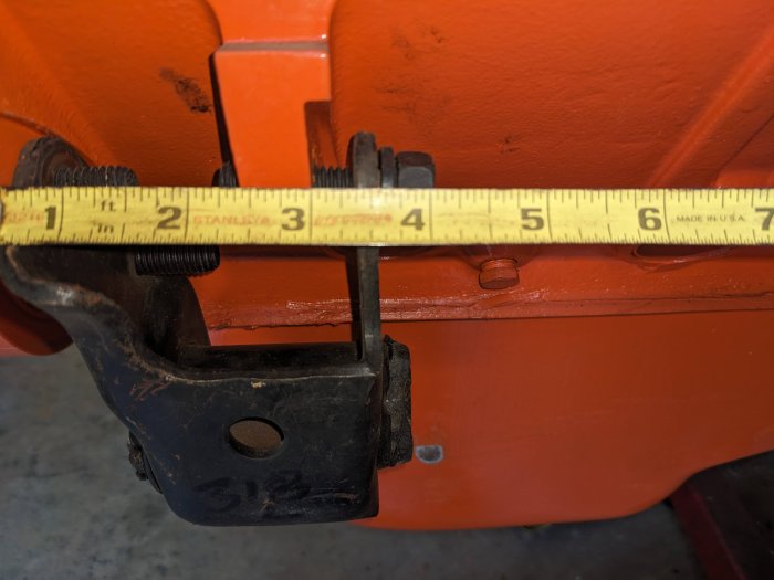

The following image shows the gap at ~5/16" - 3/8". The gap can vary at the bracket ear position due to manufacturing or handling. Aftermarket mounts might have more variance.

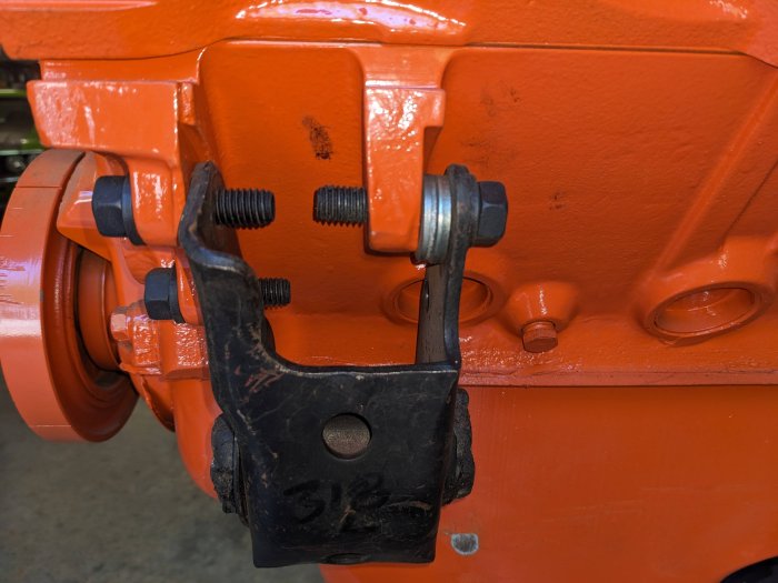

The gap can be filled with a spacer:

Went back out this morning and remeasured every thing. The original 318, the new 360 as well as the subframe distances are all the same as I installed them. Thankyou for all the helpful feedback and advice. I think we now have it. Here we go with installation !!!
