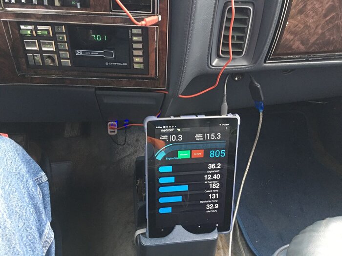

I’ve been able to start putting miles on the car and by in large have the tuning dialed in. The idle algorithm could use a little more work and I still have the closed loop fueling to tune but she’s drivable and pulls good and runs 1000% smoother
I will have some before and after MPG data in the next couple weeks to post.

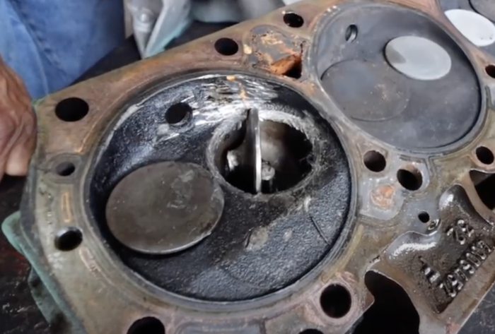

How much laughing gas you have in mind? I was loving it in my 86 Diplomat but got a bit carried away. The first time it just blew out the head gaskets. The second time they held, but I lost third gear and floated a few valves. Hopefully you go with a rev limiter and keep the gas under 200. 452 heads and 0.020 Shim gaskets with the copper goop. 150 on the spray next time

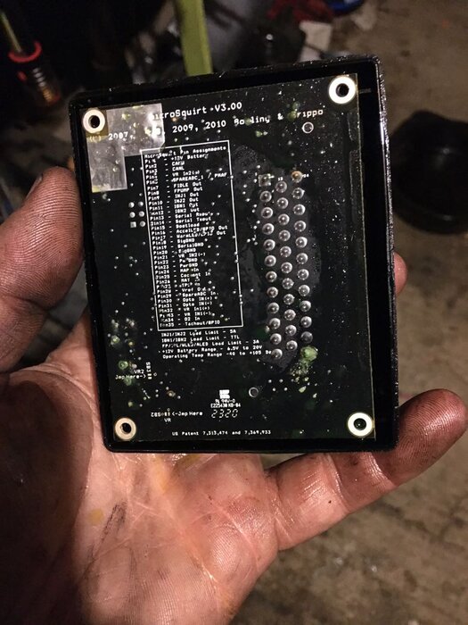

I’ve been driving and enjoying the car and up until this weekend it’s been trouble free.
but since the weekend the car has developed a strange issue I haven’t been able to diagnose yet.
it bogs down and even dies out but only when turning right and only then when you do so with a little momentum.

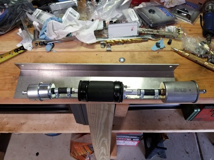

Is the fuel pickup coming uncovered and the pump sucking air? No baffling in these tanks and they don't work well for EFI conversions.

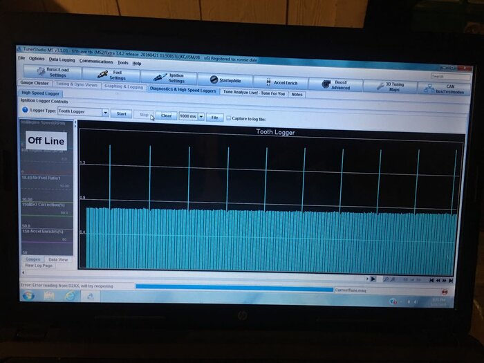

since the last post I did some driving and logging. I’ve figured out how to make it act up on demand. When it does the crank position is losing sync. It’s something to do with the sensor and mounting. I’ve already gone over that part of the wiring and it still does it.

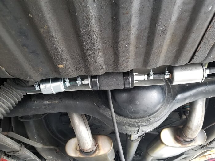

Does your setup have a fuel pressure sensor?
I have a similar fuel setup with the Sniper EFI on my car. Pump is external and mounted in front of the tank just behind the axle. It's easy to get the thing to suck air. This is why I'm building a new baffled tank for the car. I know there are retrofit kits, but they would all protrude far enough up to where they would contact the trunk pan.
I finally figured out the misfiring issue. It was essentially installation error.

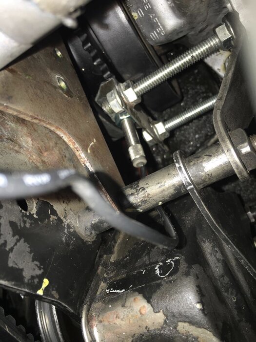

I ended up remaking the bracket and switching to a generic threaded vr sensor. That made it better but the underlying issue was still there.
well it turns out that a microsquirt isn’t nearly as water resistant as I had thought. Apparently my overflow bottle was overflowing coolant onto and into the microsquirt itself. This explains why my problem was motion dependent
