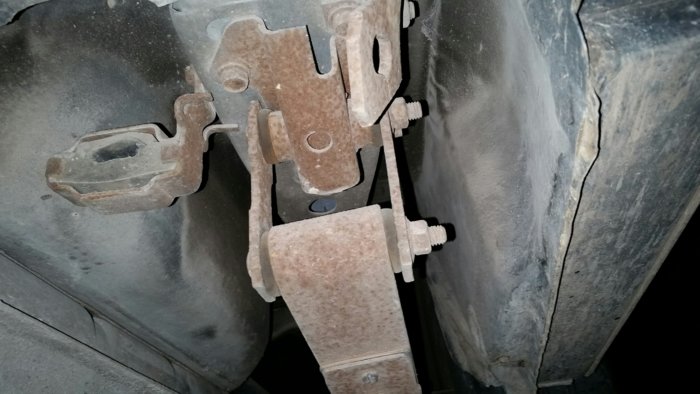

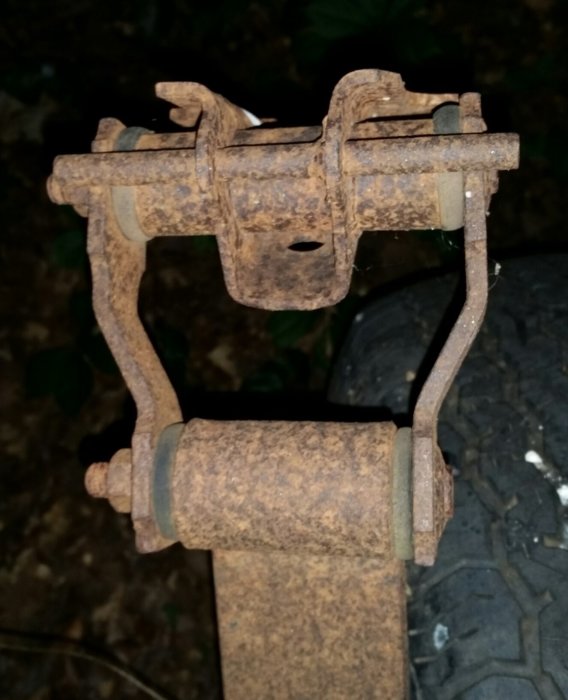

- Rear leaf spring shackle are trapezoid shaped instead of rectangular shaped. Note: the frame bracket for rear leaf spring is also different because of the wider (at frame side) trapezoid shaped shackles.
Police shackle (looking from front of car rearwards).
Non-police shackle
Note: you can see the police frame bracket "tube" is wider, than the lower version is.

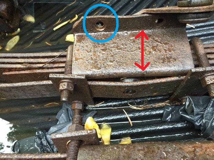

My plans (for both vehicles), is to use torsion bars (which are thicker/stronger), front and rear sway bars from FFI. Use either aluminum (or iron or urethane) K-frame mounts (FFI or other). 5-leaf rear springs (my wagon already has 5-leaf). Get rid of the rear suspension ISO-Clamp and replace with older style shock brackets (note: others have had good luck by replacing the ISO-Clamp rubber with urethane biscuits – but the lower ISO metal bracket is prong to failure - see picture, below).

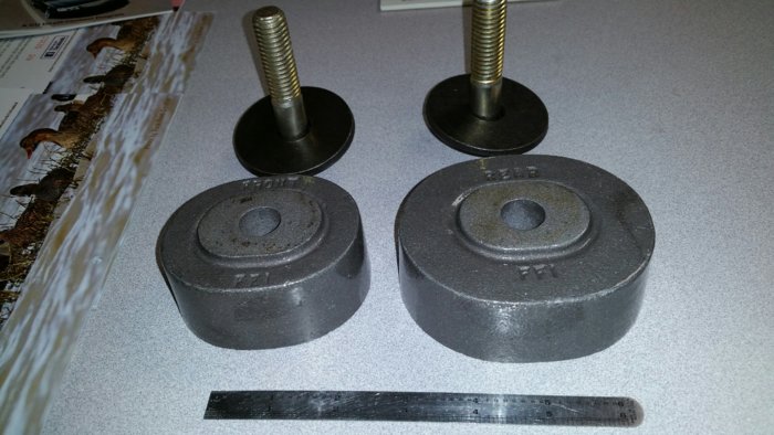

FFI aluminum K-frame mounts

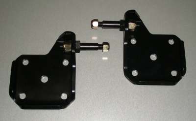

Rear shock plates. These are aftermarket - but older factory parts look close. These replace the rear ISO-Clamps and do require a different rear shock ('66-72 B-body) and longer U-bolts.
The blue circle is where the lower ISO-clamp fails at (note to self: get a better picture than this).

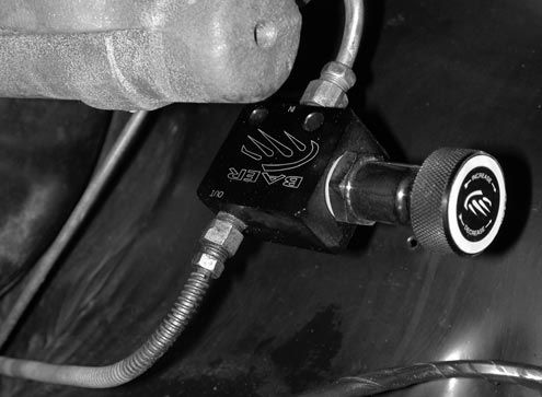

I have the cop sway bars and whole rear end w/ springs swapped in my M body. Notes:
You are not going to overpower your stock front disc brakes with the 11" rear drums. Even with stock proportioning I still couldn't lock the rears before the fronts. The difference in brake pad material up front is a more drastic change than the extra 1" on the rear drums.
Now going from drum to disc in the rear with stock proportioning would absolutely be a problem even with upgraded larger front brakes UNLESS you reduce rear brake pressure with something like this little guy on the output to the rear line...
