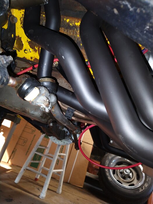

I have a set of A-body long tube headers in my, 5th Ave. fitment is just fine. They go in pretty easy from the bottom. I took this time to replace my motor mounts and install a Mopar mini starter too.
