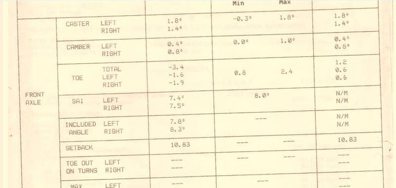

Anyone else been to the alignment shop and have a print of their alignment?? Maybe all our cars SAI measures like this on the alignment machine.
1,965
420
Is it possible that the SAI measurement is wrong, for some reason? Is there a different definition of SAI in NZ? is it possible that they are measureing SAI as mm off the vertical instead of an angle? It also seems like the camber would be off, and it looks fine from the camber measurement. Is it even possible to have the camber adjustment in spec. with an SAI so far out? Not looking to insult anybody in NZ, it just seems that the measured SAI is so far off, and so extreme that even without measuring, a 22 deg. and up SAI (if correct) would have been immediately noticeable inside the engine compartment (tilting of inner fenders/shock towers, really odd angle on the shock absorbers, something like that). If nothing appears amiss, then the SAI can't be too far off the factory spec., which calls into question the measurement itself.

We don't build the alignment machines here, I suspect they are USA made, SAI is SAI no different in NZ, there is something off and I will get to the bottom of it, if the shock towers were bent in they would be looking like the leaning tower of pisa at 25 degrees one would think. I have started another post to see what others peoples SAI measure at on our cars from the machines, I don't want to be looking for something that is not there. If it is 25 degrees it could be as simple as that's what transverse cars are and the 8 degrees is a carry over from the longitudinal torsion bars, I really don't know yet. No one else seems to have popped up yet with an SAI measurement so its not something many people wouldn't probably take notice of.

Ok here is the alignment for my 1980 Chrysler New Yorker, note the SAI is in spec on this one.
1,965
420
Brucenz;
This almost makes my point. The SAI is set by the design of the front end. It is NOT an adjustment on our cars, I don't know about all other cars, but I doubt that there are many that do allow that adjustment. The SAI is defined by the length of the upper and lower control arms, and the position of the control arm mounts (in the horizontal plane, the distance between the control arm mounting points in relation to the car centerline). For most intents and purposes, it is a check on the control arms (anything bent would throw off the SAI), and the chassis (any in or out change will change the SAI as well, this change indicates a control arm mounting point change, i.e. something has moved the chassis mounting points). The >20 deg. SAI that you were shown for your Cordoba is way off, so either the upper control arms are too short, the lower control arms are too long, or the control arm mounting points are way off. I don't think that any of this is true, I think that the measurement is off, and substantially so, which is why I am asking about the measurement method and the actual measurement taken (deg. or mm.)
The reason I don't think the measurement is right is due to all of the other measurements being in spec, and nothing otherwise seems to be out (leaning shock towers, excessive camber, etc.). Is the shop that did the alignment on your New Yorker still around? Is the guy who did the alignment on your New Yorker still around? If so, you may want to take the alignment sheet from the Cordoba to them and ask him/them to look it over, and render an opinion on the SAI.
